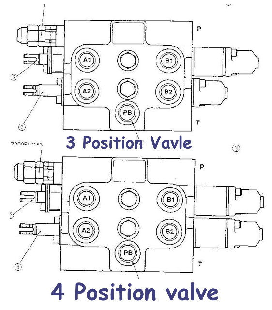

Peter, there's an easy way to tell at a glance, but looking at the front end of the valve (opposite the linkage). Let's see if this picture works to show the obvious visible difference.
Oops, wouldn't you know I'd misspell a word?/w3tcompact/icons/frown.gif Oh well, you know what I meant./w3tcompact/icons/grin.gif

Bird, you have the "speed dump" option. Check out 3-pos-vs-4-pos valve, post....
