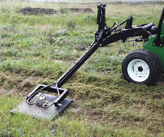

Here is the PowerTrac boom cutter, and some others built by a PT owner Stray.

Yea JJ thats what I'm talking about. Only I need a longer reach, the hills here in WV are higher. :laughing: I'll take some pics of what I have to cut. Maybe I should rethink it and mount a brush hog on a small dozer.:thumbsup:
