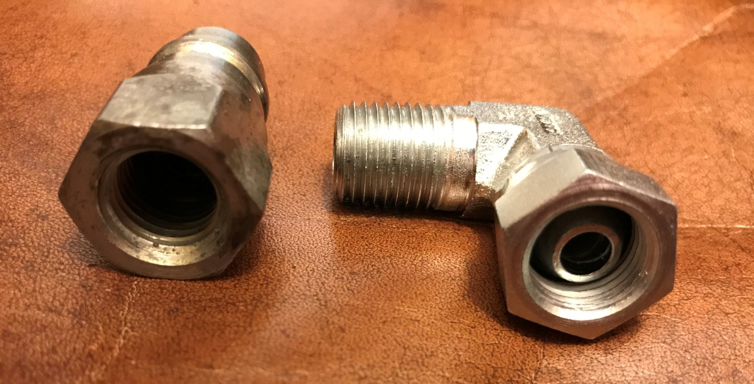

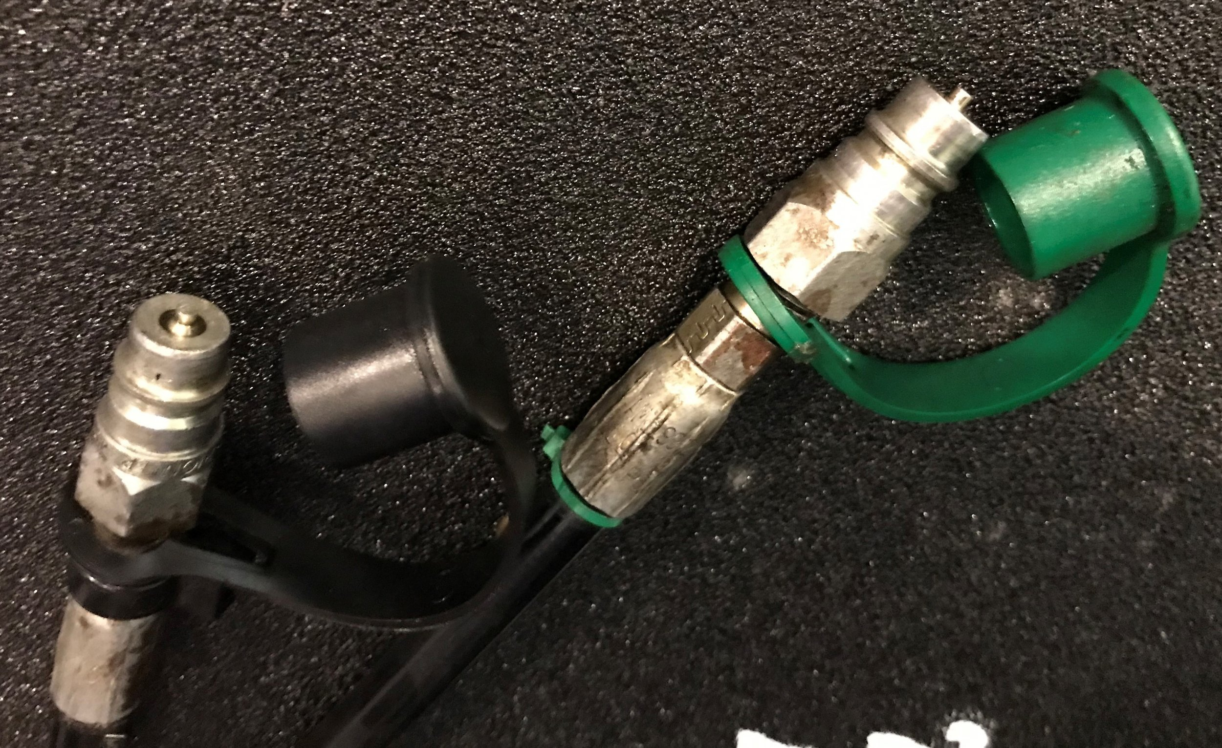

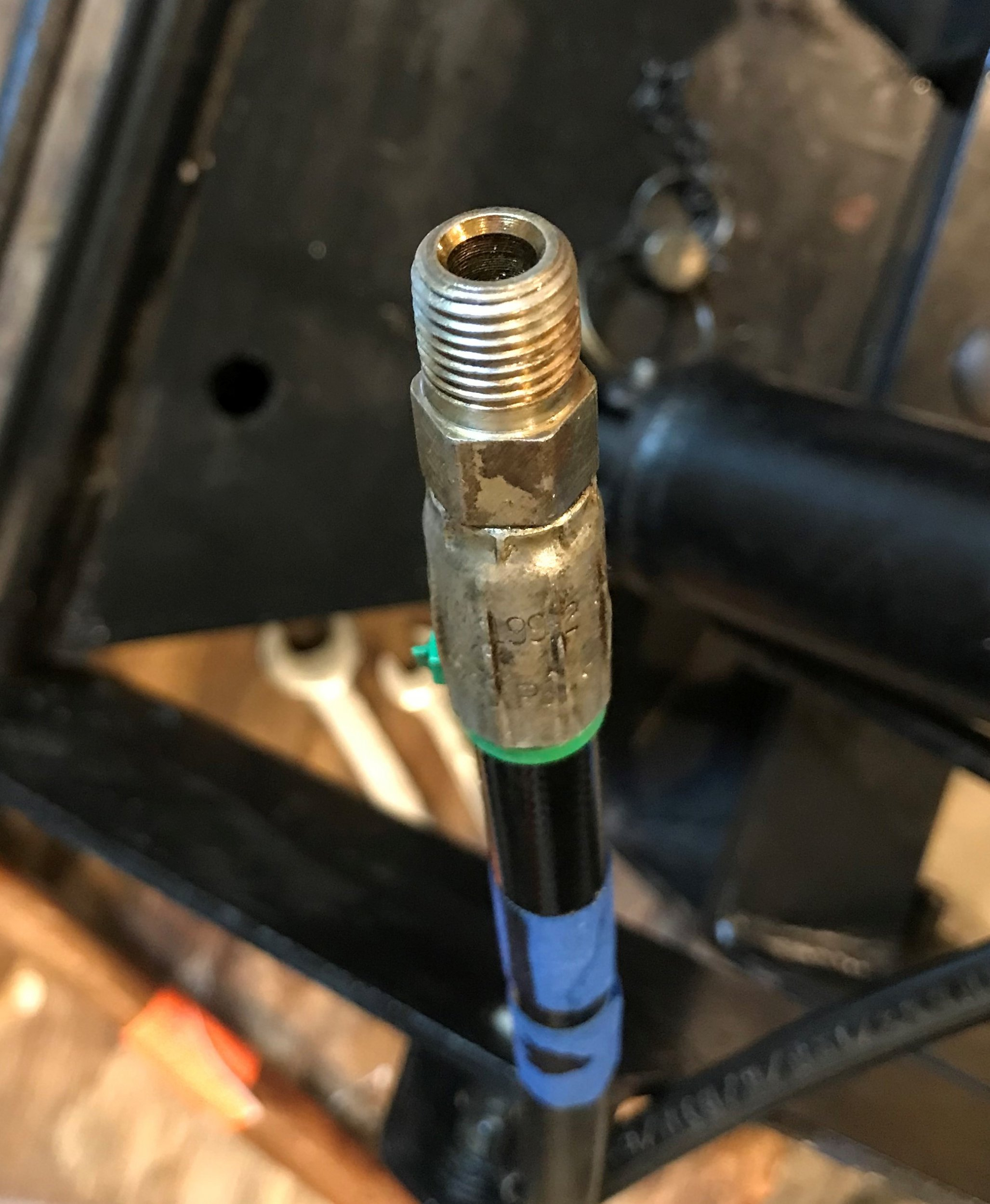

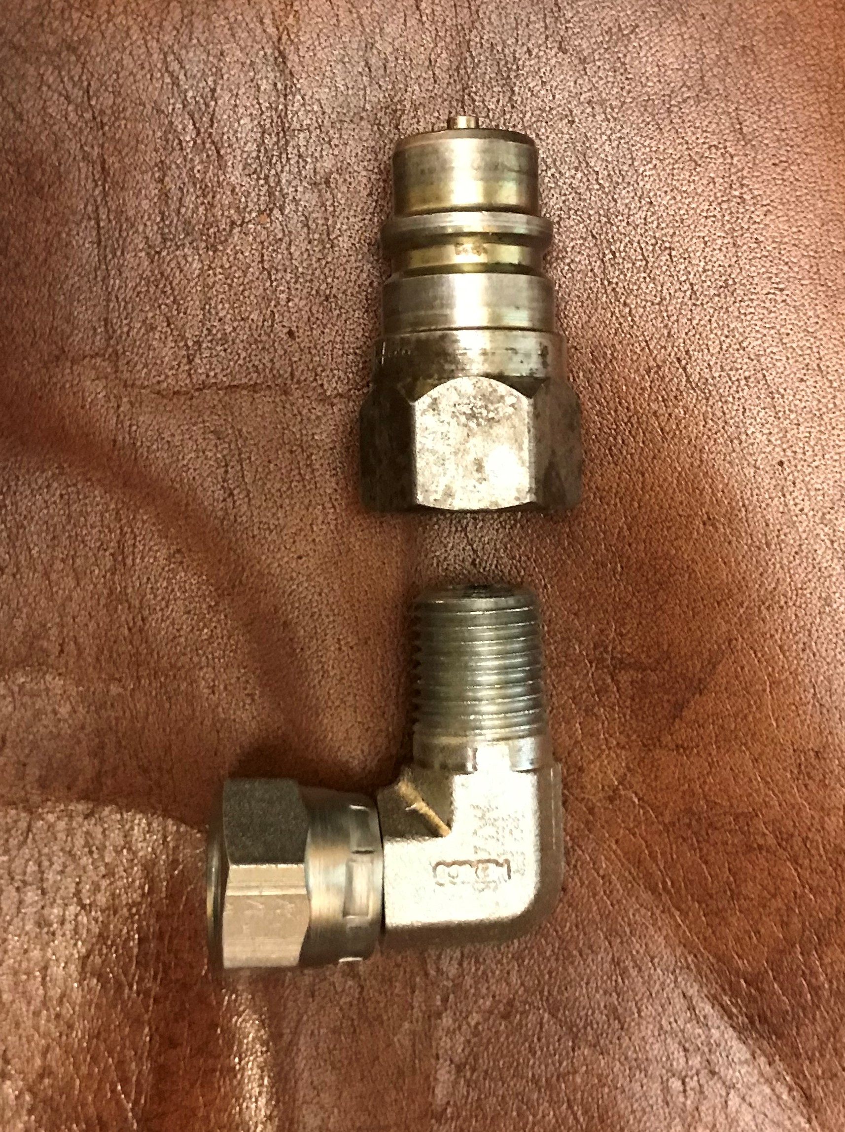

OK, next Hydraulic Connection question PLEASE. Attached find (3) Pics, the first shows the two Quick Disconnect lines originating from the Front Quick Hitch BM17347 headed into the tractor's Green and Black ports, sorry for the incorrect terminology. Taking the Quick Hitch from a JD425 and now using it on the (2021) X730, to do that it requires 90-degree elbows. In the 2nd Pic it shows the green line with the quick disconnect nipple removed, looked like remnants of a white substance in the thread, perhaps Teflon Tape or Pipe Dope which I removed. The third Pic shows the nipple and the 90m degree elbow that JD sent along with the tractor for this application and lastly, the 4th pic shows the insides of the nipple and the 90-elbow sent by JD Dealership.
So, in the original connection between the nipple to the hose threaded end I didn't see where the use of an o-ring would apply. Would this indeed be a place for tape or pipe dope, or should it have another coupling in between. Similar question with the new connection between nipple (female) to the threaded end (male) of the JD supplied 90-degree elbow. Tape, or pipe dope ?

Those look like pipe thread fitting so yes some form of thread sealant is required.
   / Hydraulics 101 - Connections
Oldnslo, THANKS ! Just picked up some Pipe Dope @ HDepot. Want to get these new elbows finished so I know I'm set this coming winter.
Just returned the Pipe Dope and purchased Loctite 545 Thread Sealant for Hydraulic Fluid, mentioned in this YouTube on NPT Connections
Here's the NPT Fitting Guide used in the video.
