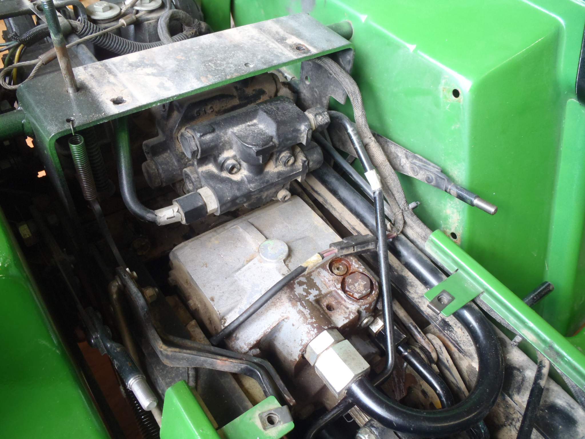

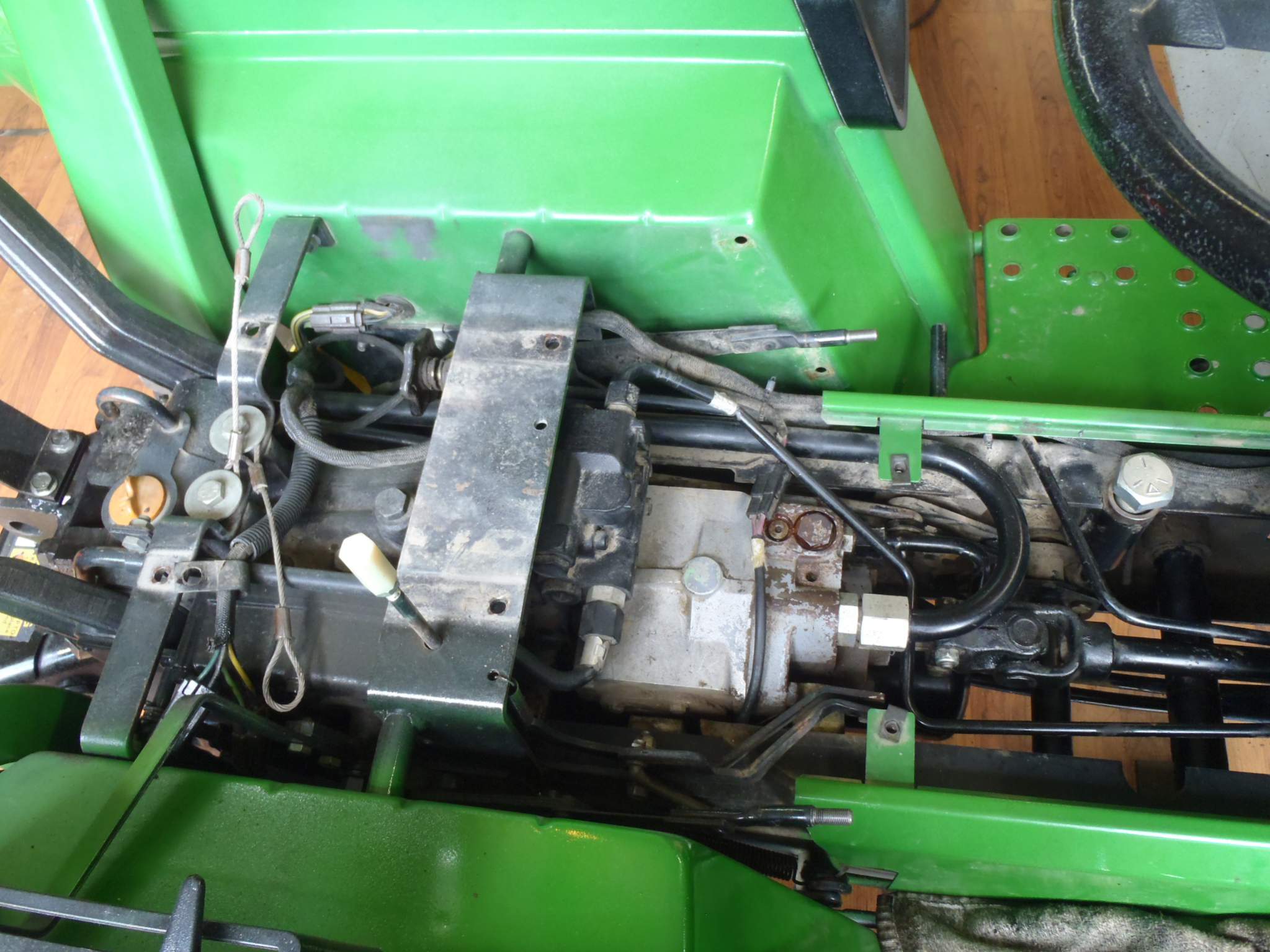

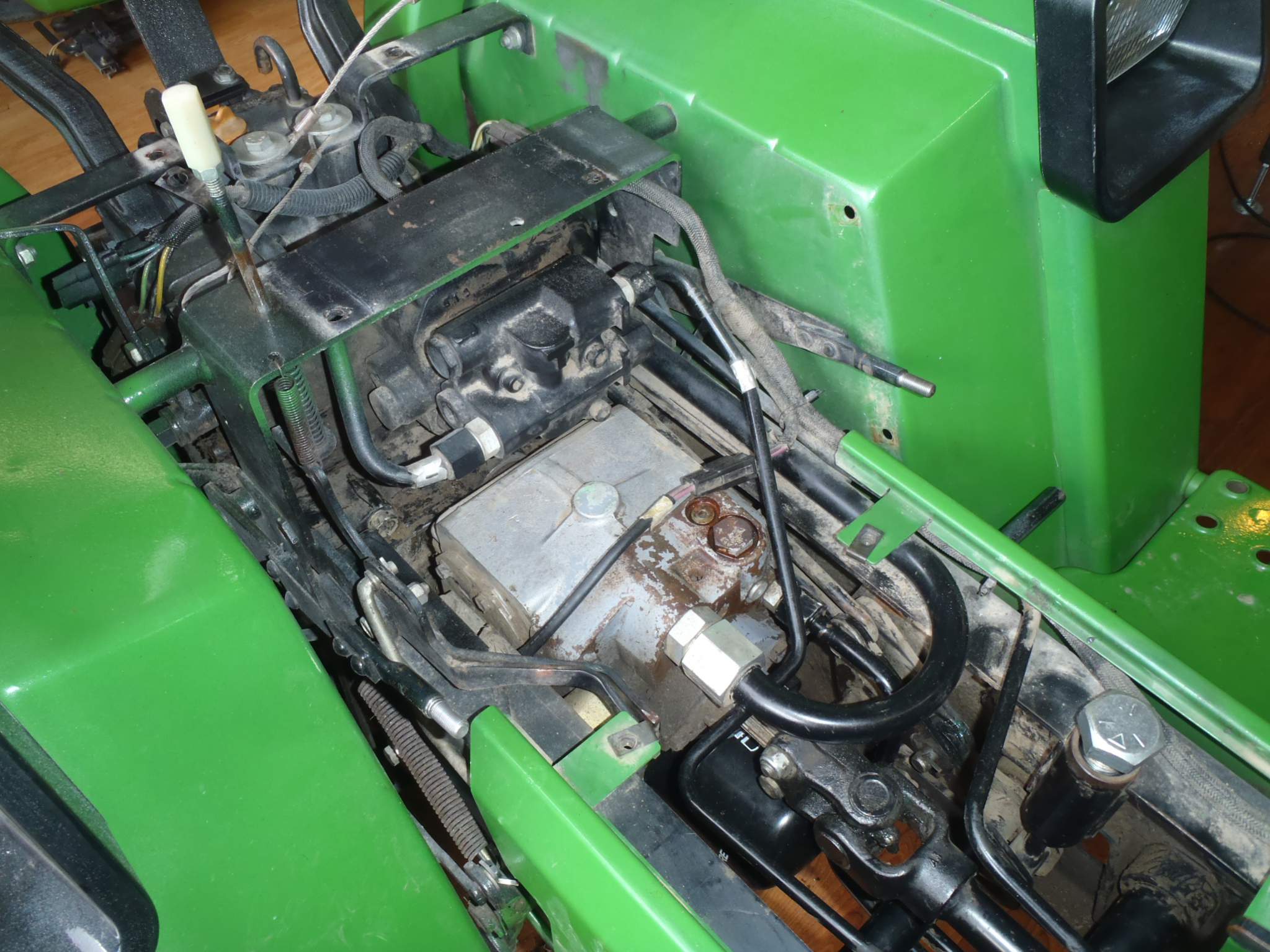

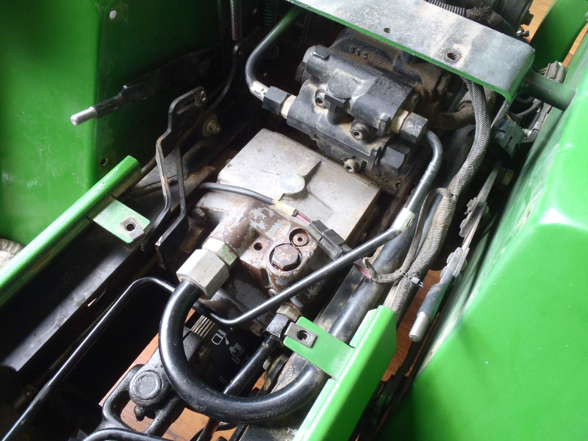

Hi all, could someone tell me what extra hydraulic valves and etc. i would need to run a loader on my 755. i've attached a few photos of the pump/valve area with the seat off. I've looked at the westerndorf, ctc, and the brushhog. westerndorf comes with a control valve and control valve lever to operate loader, but it's $1000 more! I looked at the diagram in manual but the valve they show looks nothing like what i've got. perhaps someone here knows what i'd need or if simply buying a loader with new control valve is the best way to go.

Your best option may be to get the valve with the loader. The kit to add the valve is no longer provided by John Deere as far as I can see. The individual parts could probably be purchased, but the parts would almost certainly exceed $1000.00. The flow divider alone lists for over $1100.00! That doesn't include the two control valves, lever, and hydraulic lines. Just be sure the valve you get includes everything you need to connect to a 755. Another option would be to locate a used valve at a salvage yard. Again be sure you get all the required pieces to hook it all up.
   / hydraulics for loader on 755
thanks for the nudge to get it all at once. i think that's what i'll do since the cost to get loader and valve separate might be similar price as a package with it all included. plus i'm not all that familiar with what parts i would even need. thanks again. damien
