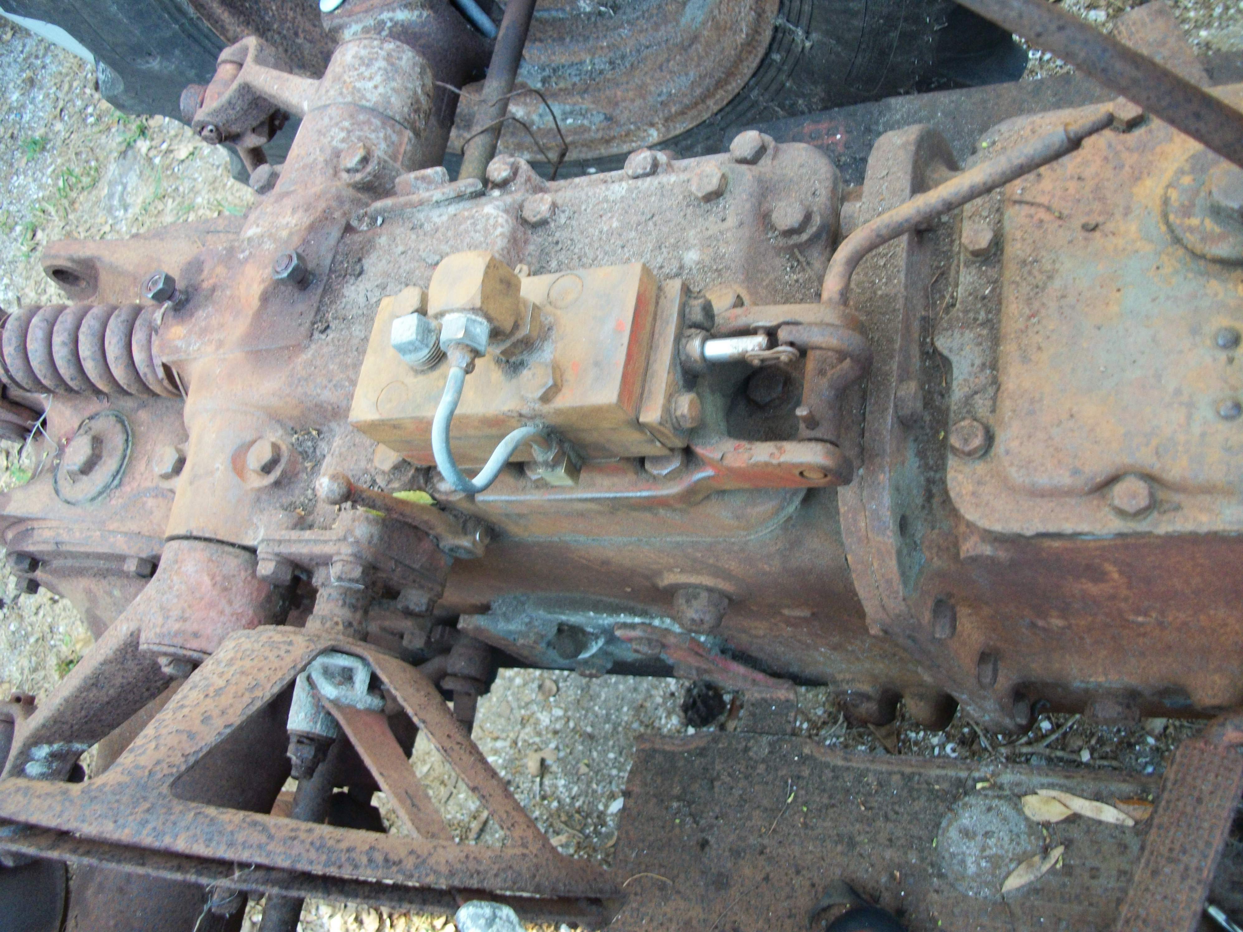

Working on jube this wknd, could not get hyd. to do anything. I have piston pump, friend stopped by said to remove plug from top of pump, screw in nipple ,hook up piece of tubing to hyd. fill hole and let cycle. Ran tractor for a while pumped oil thru tube still nothing. any suggestions. Thanks

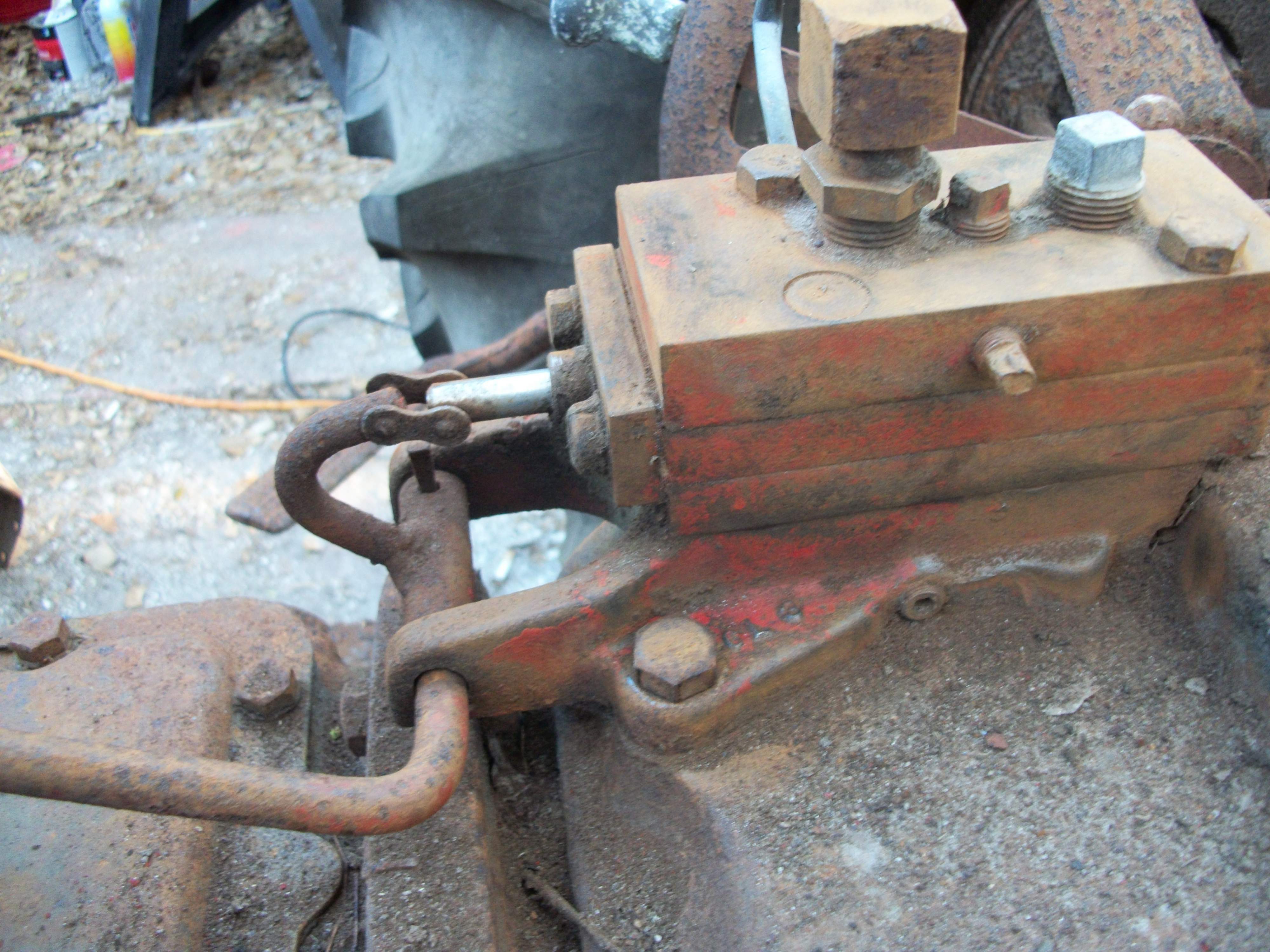

Thanks SG I'll try what you said But i dont have a cover under seat i have some kind of lever see pics.
   / hydraulics not working #4
ok.. you have the rare remote valve. se if it is accidentally engaged. if it is.. there will be no 3pt hyds.
I really don't know how to disengage, its not like pto lever or draft control where its in or out, this lever is spring loaded. Do I need to hold back on lever while using 3 point lift @ same time. Sorry for all the questions, just never seen one. I appreciate your help. Thanks
   / hydraulics not working #6
it should have a neutral position, and either 1 or 2 engaged positions.. depending on if it is SA or DA. if it feels spring loaded and is centered.. it is likely in neutral.
you can always remove a plug froma working port and see if you have oil at the remote port.

There is a plug on top back behind fitting with 1/4 " tubing ,i will check that. also do you know antbody that might have a used top cover plate.Never had one of these remotes before
i dont know what i would need that for.
   / hydraulics not working #8
the come up for sale on ebay now and then.. generally hard to find as they were only used on the naa and that was a 53-54 machine. however.. that remote is a valuable piece too. you may simply want to keep it.. it's the easy way to add remote hyd options to your machine.
