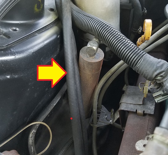

I own one of the very few surviving Trans Ams from the 1980's television series "Knight Rider". A true childhood dream come true. I am working to restore the car to its as-used appearance on TV.
What makes this car interesting is that the factory suspension has been augmented with some hydraulic cylinders designed to raise and lower the car.
After much research, it was determined that this car was outfitted with these hydraulic cylinders for a specific episode where K.I.T.T. can lift his body to clear some terrain. Here are the screencaps showing the car before and after the suspension lift:

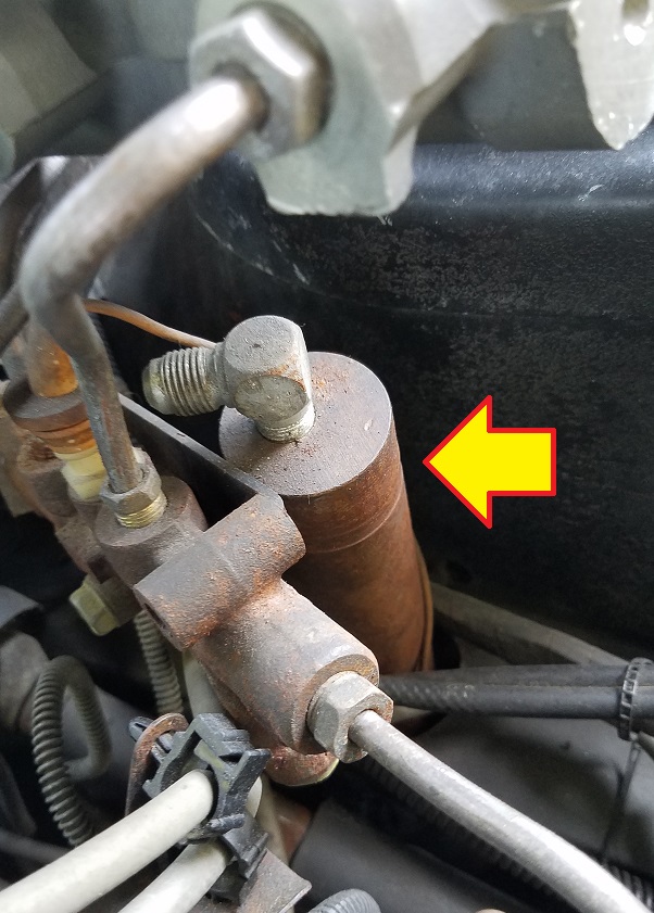

Unfortunately, in the years since the show has been on the air, most of the hydraulic setup was removed. Presently, only the front hydraulic rams are still in place:
These cylinders are welded to the car痴 unibody and, when activated, push on the lower control arms to elevate the car.
The rear cylinders are gone, but the holes where they were mounted are still there, along with some of the welds. The hydraulic pump and all hoses are gone.
My goal is to re-create the rest of this setup using parts identical to the original 1980痴 era ones. Unfortunately, there痴 no markings on the two hydraulic cylinders, so I cannot find a manufacturer in order to find two more for the back.

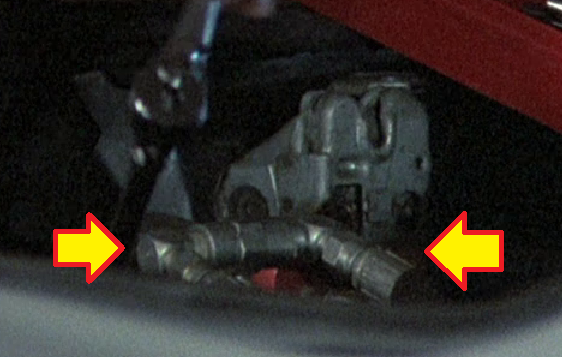

There is a brief scene in one of the episodes where I can make out the very top of the hydraulics in the trunk area (see below). Looks like the pump is in the trunk and the line comes off it and splits into two.

Back in the 80's & early 90's there were several companies selling kits for making cars into low riders or for bouncing or hopping them. Majority of them that I know of were based in California. Not sure how many are left today but you might want to try some searches for low riders, car hopping or jumping. If I remember correctly Red's low riders was one of these companies.

I'm guessing that the cylinders are shot because the port is open to atmosphere, which lets dirt in, and they are running without oil. At a minimum you will need new seals, but the bores are probably scored and unusable. ISZ

To give you a bit more info. The cylinders on the front are 1.5". They welded a plate to the TOP of the front springs, so when the cylinder is activated, it pushes not on the control arm, but on the top of the springs, which in turn push on the control arm. I don't know the stroke as of yet, but judging by the scene in the episode where we see the car lift, it's only 2-3 inches in the front and 5-6 inches in the back.

I pulled off the fitting from one of the cylinders, and it's filled to the top with hydraulic oil. I had originally thought they were pneumatic until I saw that.
