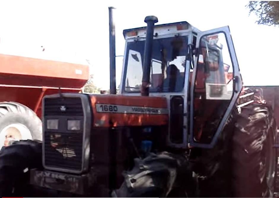

Hi could anyone give me any advice on why hydraulics have just stopped working on a Massey 1680, 1995 model. No flashing lights or anything. I’ve checked all fuses

What's a 1680?

How is hydraulic pump driven?.. Mechanical lash up or belt driven?.... I guess what I am asking is how does hydraulic pump get its power...
   / Hydraulics problem #6
Many of the Masseys are in the rear end.
   / Hydraulics problem #7
I have one of those that has a good pump. I bought it to take the gear shuttle out of it and replace the hydraulic shuttle in another tractor. You may have sheared a drive or maybe it's the pump itself. But, if it was working fine and then just stopped working, could be a smallerish problem. Your bypass spring could have broken. Letting it bypass instead of work. Does that one have the 3 range 24 speed transmission?
