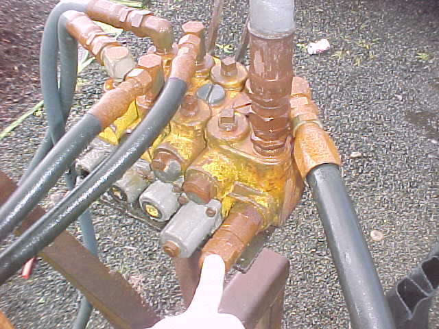

I would not adjust the pressure relief valve on the tractor. Besides writing off the warrantee it could cause damage to the system.
For other systems, the relief valve is built right into the spools. It generally looks like a bolt with a slotted head for a screwdriver with a jam nut on it. It will be near the input line of the spools. There again, be sure to have a guage on a pressure port when you adjust it. Don't overdo it, it will not make anything work faster, just bends things better.
The pic will give you an idea of what to look for.

Didn't notice until I looked at the pic, excuse me for not being more politically correct.
