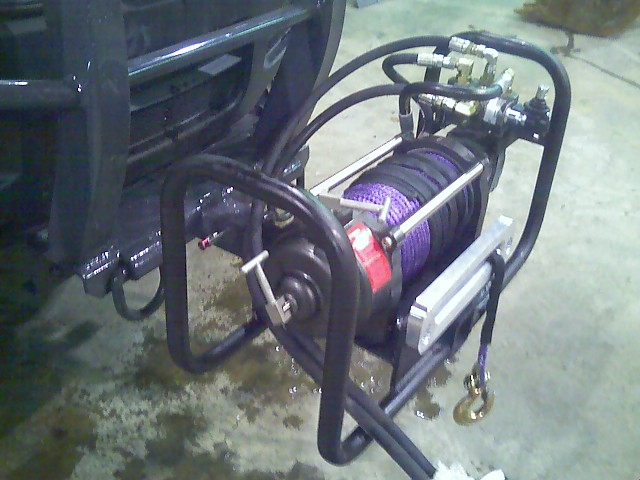

I was investigating a winch to pull logs in the forest, and it looked like the electric could prove frustrating. Has anyone used a Mile Marker Hydraulic winch running off the bed hydraulics of the rtv900. The specs say 3.5 gpm @1500psi for the winch.

I spoke to the tech at the winch place today, and he said he didn't know of anyone putting a hydro winch on a utv. He also said to keep the pressure around 1500psi. Anyone know the flow and pressure to the bed lift on the rtv900? I thought it was written in the manual somewhere but I could not locate it. Three or four gallons per min at 2600psi sound familiar?

i put one on the rtv1100. goes front or back

That link and setup is exactly what I need. Do you think the syn rope will hold up to hauling logs? Can you provide any other details which will save me from being the inventor. Do you just attach to the dump hydraulic quick couplers?

Hopefully there isn't a lot of stretch in that line so it won't come back and cut your head off if she snaps. Not a pretty vision. -I'm sure they did their homework before deciding on a rope material.
