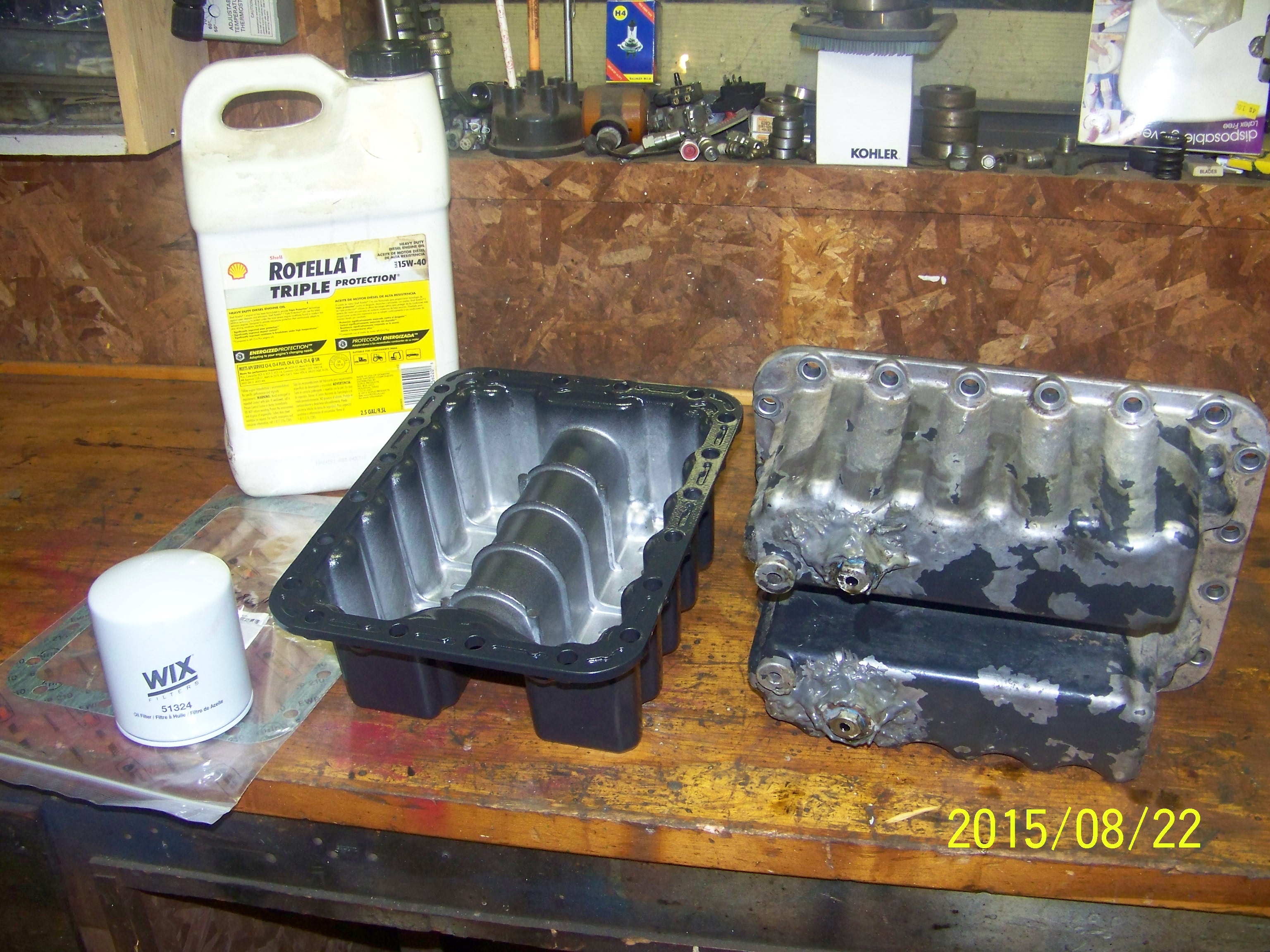

I couldn't find torque values in either Bobcat manual or Kioti manual. I Bought mine used and unknown to me at the time someone had actually broken the oil pan on both sides by overtightening the plugs. I had to change the pan. Saying all that to let you know that pan is cast aluminum and can be broken so don't play strong man. That JB weld was my first attempt at a solution.
