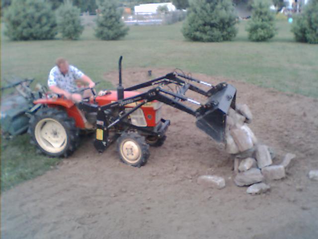

   / Hydro pump GPM? #6
I have a 1500D with a Koyker 110 and it works great. It's amazes me what I can do with this little tractor and loader. Don't know how I ever got along without it!
