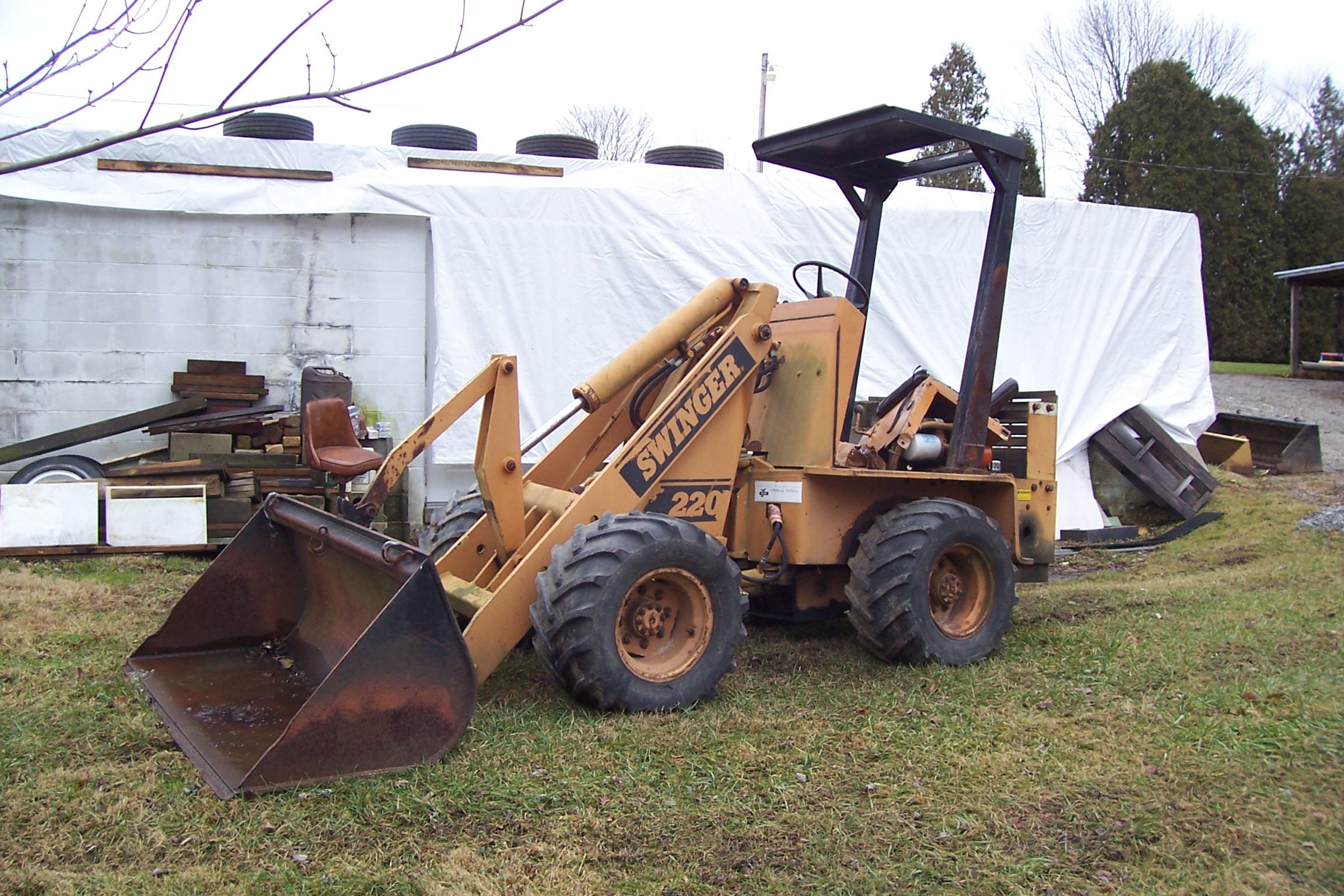

I have an older Swinger 220 Wheel loader that has a Sundstrand / Saurer/Danfoss hydrostatic variable displacement piston pump, and a fixed displacement piston motor. The previous owner or owners must have dumped automatic trans oil in the hydro oil tank, and now the system is full of a oil that resembles pepto-bismal. I drained the tank, drained the hydro cooler and filters, and got all the fluid i could get out of the cylinders. I added 5 gallons of new aw46 oil. The oil still looks reddish and now the pump/ motor doesn't want to drive the machine at all. Will move but no power. It may have fine air bubbles in the oil. What is the best way to purge the system of all the old nasty oil? And what is a good oil specifically for these hydrostatic transmissions? And should I be running an anti foaming agent? Thanks for any input.

As to the fine bubbles letting it sit overnight should let the bubbles rise and collect. Bleeding should get rid of the remaining air.
Any chance of getting a manual on the unit? I would go with the OEM oil recommended.

Red comes from the dye companies use to spot leaks. It's not specific to ATF. We have a red dye in products out of our plants in America and fluorescent green in our European plants. So just because you see red oil does not mean it's bad. My Cat mini-excavator, built in the UK, came with red oil and still looks the same red despite my using non-dyed oil for replacement.
It really sounds like you have a component problem.

Well the oil is still milky looking a little less red. I let it sit overnight and run it around today and the performance is still lousy. I think your right MHarryE, the pump and motor need to be rebuilt. The warmer the oil gets the less it wants to go. Hopefully they still carry parts for it. Does anyone have any ideas about how much a rebuild would cost? I will be removing the components myself, just not sure what to expect.

Some older Sundstrand products recommend ATF as the fluid of choice. Sunstrand became Sauer Danfoss and is now just Danfoss. They should have rebuild options on most of there equipment. Cost depends on size of components and what is required to get them back operational. I would budget a minimum of $2500 - $3000. This estimate could be high or it could be low.

I run the machine yesterday and when the oil is cold and thick it will drive a whole lot better. Im sure the pump and motor are a bit worn, but could it be possible that the oil is the wrong viscosity? Im sure the old oil was contaminated and thin. Not sure if i want to keep dumping oil at it?

Yes, your symptoms are exactly what happens when hydraulic fluid is used in a system designed for motor oil.

If its supposed to be motor oil, Then then what type should I run? And should there be a anti foaming agent added to it?
   / Hydro static fluid / drive problems #10
Try 10W-30 motor oil, and it can be found just about anywhere. . We don't seem to have a problem with foaming, even though it is a detergent oil.
This is what we use in out Power-Tracs.
You can use synthetic if you want.
