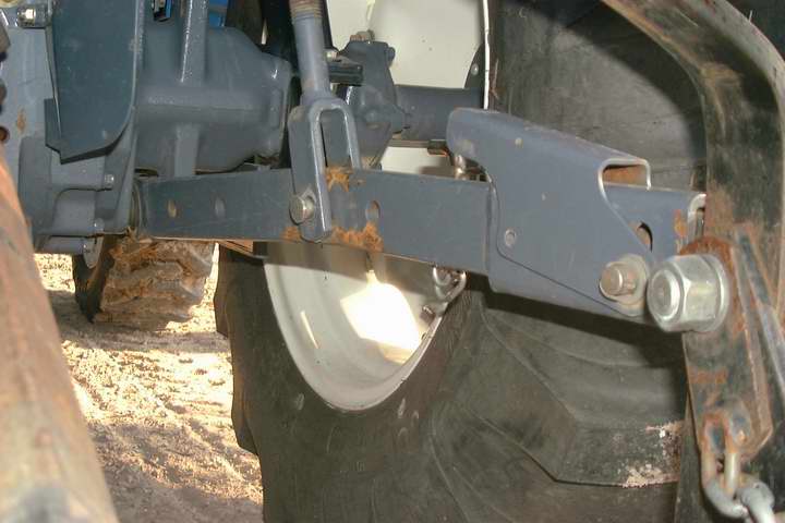

David, I don't know how old your tractor is or if you still have any warranty left, but here is some info that helped me get both of my lift arms replaced for free under warranty. I have the dark grey running gear tractor that was one of the early ones with weak lift arms.
This info from SPENCER200:
</font><font color="blue" class="small">( If you are still under warranty New Holland should replace your bent arms. They are aware that the original steel in these was too soft and replaced them. Have your dealer refer to asist bulletin Rq8908 Class 3 boomers Serial number g508677 and up came with the improved arms. If you do have the improved arm New Holland will still replace if under warranty. Standard Warranty applies to this problem
)</font>
I'm attaching a photo of my bent lift arm. My new arms are painted black.

Used my TC40D for SERIOUS 3ph work yesterday - using a 2-bottom plow on my wife's garden. I thought the HST was wonderful for plowing - much easier to use that the old Ford 2000, which always stalled when I hit a root.
Anyway....I was taking off the plow to hook up the disk harrow and I noticed the right lift arm beginning to distort in the manner of your picture. A quick check of the s/n shows my tractor was built before the ones spencer200 listed. My dealer is getting a call this morning since my warranty is up next month. I'm glad you posted this information again, Jim.
