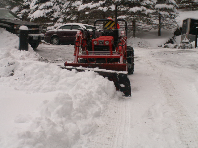

I have a 03' B2410. Is the Hydrostat rugged enough to handle a 4' blade to level gravel and push snow? Thanks
   / Hydrostat ruggedness #3
I have an older B2710 with hydrostat and have used a 6 if not 7 foot blade on it. The limiting factor was traction. Have used it a good bit with 6 foot landscaping rake pulling a good bit of dirt with never an issue. Just don't use in higher range than you should for load.
   / Hydrostat ruggedness #4
Actually, I would get a 60" blade for that tractor if you have a choice. It will cover your tracks better when angled, and have a bit more reach for ditches, etc.
   / Hydrostat ruggedness #5
Had B7100HST smaller than yours,14 years pushing snow plus w/6' blade no problem..take it easy until you get the feel.
