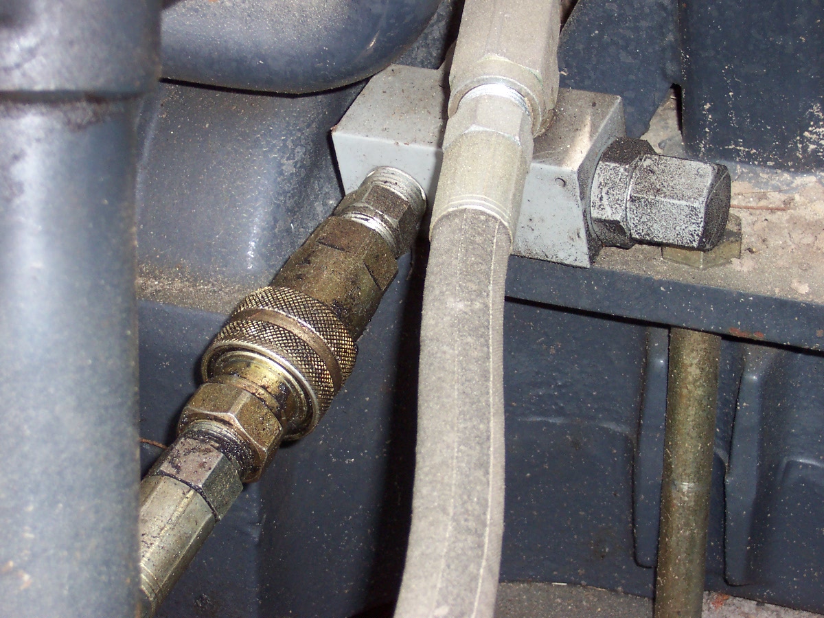

I put rear remotes on my 3510 to run a backhoe. I adapted a Jinma Hoe to fit my tractor.
I put a pressure relief valve in the circuit to protect it, the worst thing you can do to hydrauilcs is to "Dead Head" them, something WILL break. I store the hoses connected to keep things clean.
First pic is the rear remotes and second pic is the ajustable relief valve.

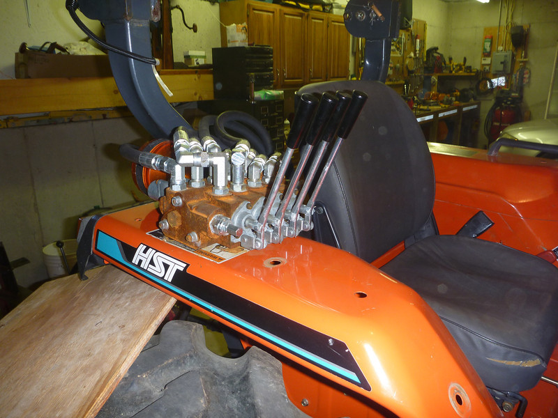

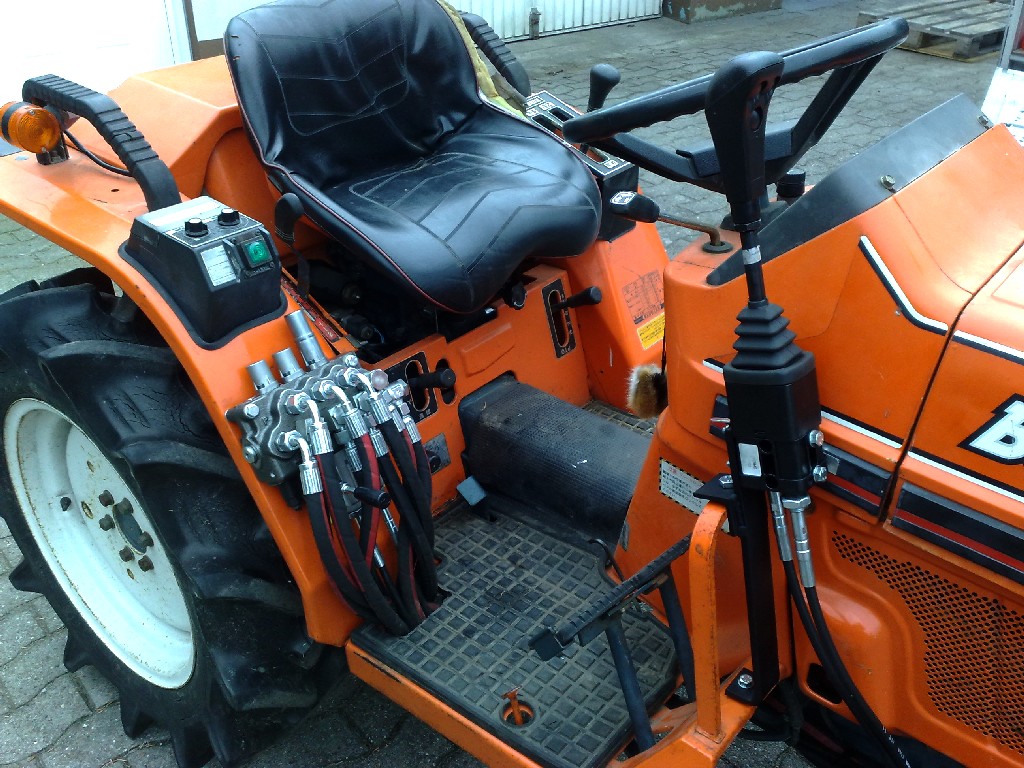

Don't know exactly what you have now for hyd, but if you have a FEL, and it has PB, then the PB from the FEL valve will connect to the IN port of a 3 or 4 spool remote ,The PB from the remote valve will connect to the 3pt connection, and the tank hose will go to tank.
You will need two spools for the T-N-T, and maybe two for other hyd implements.
Some of these spools can have detent, float, or even a motor spool. If using a stacked hyd valve, you can designed it the way you want.
The average person should be able to do the installation, and there are plenty of people on here willing to help you. Just ask.
Some places to consider for valves are
Surplus Center
Bailey Hydraulic Cylinders
Manufacturer

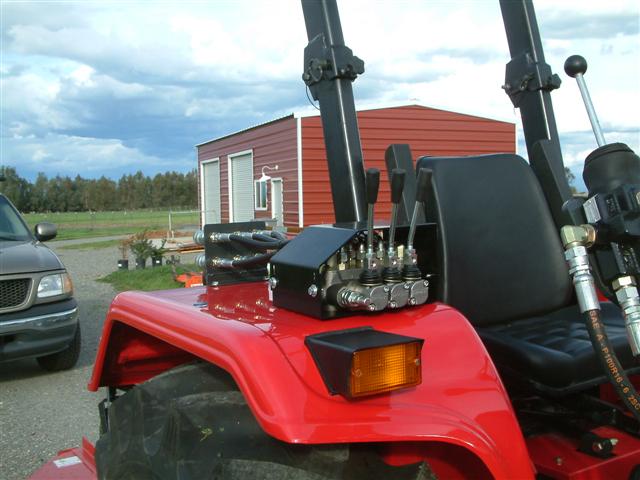

Some remote valve installations.

Just curious about the relief valve you installed.
Most relief valves have three hoses, IN, OUT, and TANK.
Check and see if there is not a plug in a port marked with TANK, or just T.
Did you set the relief pressure?
Inline (3 port) connection relief valve
http://www.surpluscenter.com/MorePhotos.asp?ITEM=9-1556

I put a stack of 4 outlets on a 42 HP (Large frame) Kukje tractor by using the outlets just above the rear axle.
These are high on the right hand side and as shipped from the factory they are connected together by a short steel pipe and a couple of large banjo bolts.
I forgot the thread spec., but it is SOMEWHERE in this forum.
This avoided all the worrying about power beyond, just one hose out and one hose in.
