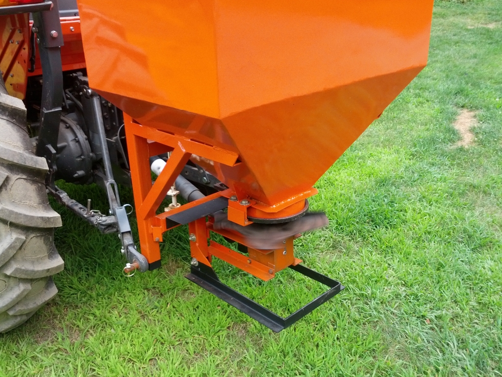

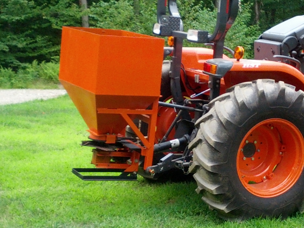

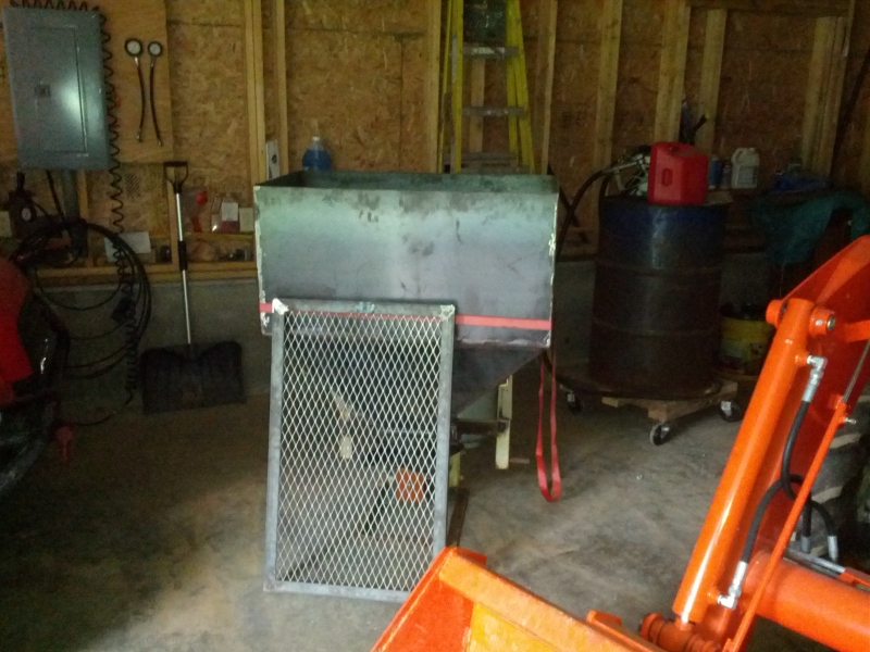

A couple of months ago I picked up a used Herd 750s spreader. It had been left on it's side with fertilizer still in it for some time. I got it for a pretty good price. My original plan was to patch the holes and use it the way it was. But I ended up rebuilding it from the ground up. I ended up cutting the hopper off and throwing it away and building my own out of 1/8" steel (much thicker than stock). I also replaced the fan and the aluminum base plate for the hopper as they were corroded from the fertilizer (or salt). Since they didn't cost much I bought new shafts going into and out of the gear box along with new seals.
I also built a frame out of 1 1/2" 1/8" angle with expanded metal that slide over the top. It'll keep anything too large, like rocks or ice, from getting put into the hopper if mixed into the sand.
I think it's a little small for my tractor. If I lower the 3pt all the way down the PTO shaft will hit the draw bar. The draw bar is used to hold the rear of the sub frame up so I'm thinking I'll get a piece of steel that's shorter but otherwise the same dimension as the draw bar so they don't interfere.
I still have to install the gate at the bottom of the hopper. I have a piece of stainless I'm going to use for it. I haven't even looked at the auger inside the hopper to see what that will need. I also haven't painted the part for the top yet. I put stainless weld nuts inside the hopper to fasten it to the hopper.

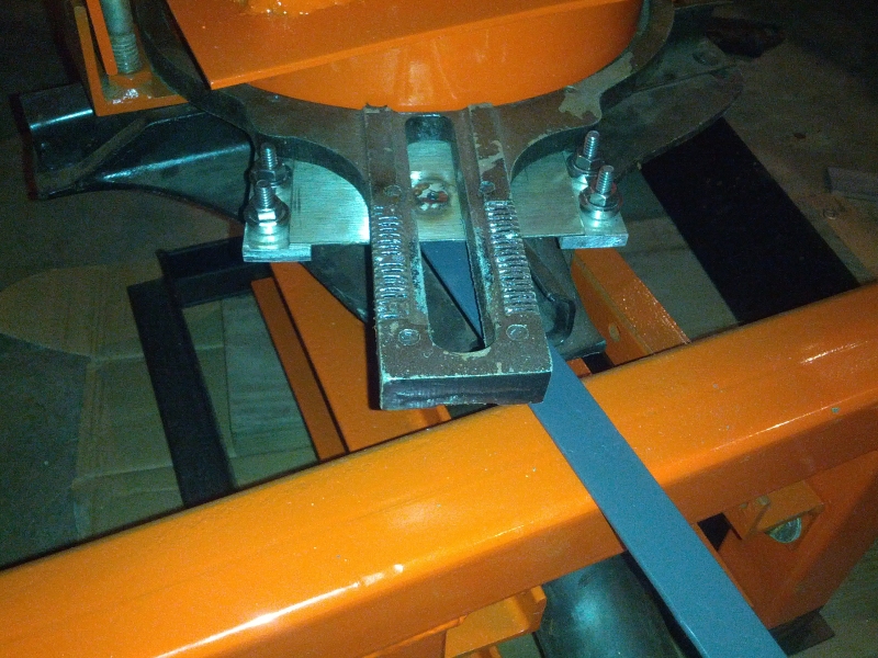

I haven't had a lot of spare time but I finally redesigned the gate in a way that I like. The problem with the original design is that when the gate is open there's very little to support it or keep it straight. If you pushed on the lever to open or close it you could force it and make it work. With the modifications I've made you can open and close it with one finger now. If anyone with a herd seeder wants me to I can take some pictures.

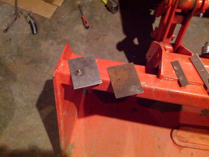

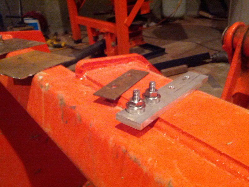

The two pieces of steel that are the lower guides for the gate are 14 gauge steel and are 1"x 3 1/2". The gate is also 3 1/2" so when the gate is open there's not much holding it in place. I remade them out of 1/4" aluminum and added 2". Because the lower hopper plate rotates to adjust left to right where the sand goes the gate doesn't always get pushed straight on to close it. What was happening is the gate would jam.
I had some sealed flanged bearings (1/4" ID) that I mounted on the extended ends of the 1/4" aluminum. Now when force is applied to the gate to close it there's no way it can jamb. The more the hopper base plate is rotated the more the bearings guide the gate. I don't think bearings are needed, just a flat edge that keeps the gate in line would work. Also the flange is not needed as the hopper base plate keeps the gate from lifting up.
Here's the old and new lower guides. The screws are flat headed so the arm that connects to the gate will not rub. I didn't have the correct length on hand so I either have to cut them down or get shorter ones. I'm using all stainless steel hardware except for the lock nuts. I made sure there was enough room between the heads of the bolts that hold the guides to the hopper base plate and the fan.
Here's the old and new gate. I welded a flat headed screw to the gate after using my press to countersink it flush on the top. I also added a brash bushing for the arm.
