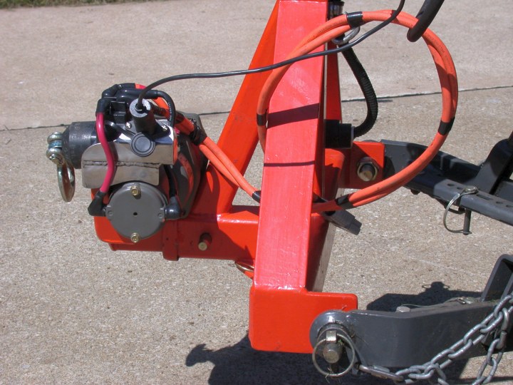

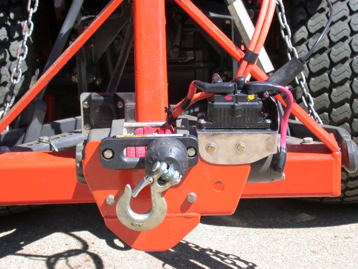

I added a Warn ATV winch to the BX
   / I added a Warn ATV winch to the BX #1
HarleyScooter
Gold Member
Jun 2, 2004
260
Canton, Ohio
Kubota/ BX2230
I had a Warn 2500 lb winch on the ATV and I never used it. So I added a 2" square tube and some gussets to the mounting plate and a extra mounting plate for the relay and remote switch connector. Now it is all in a small unit with the only connections needed are the 12 volt power and the remote plug. I used 120 amp connectors for the 12 volt power leads, I bought those from Granger.

This looks like it was made for the tracktor Very nice
Thanks Doug, the winch will fit on my little log skidding setup. on the boom pole, and on the counter weight I made for the three point. I have plans to dig out the small pond my daughter has in her back yard, I thought I could use the winch if (when) I get stuck doing that.
   / I added a Warn ATV winch to the BX #4
Nice idea. Of course, next week you'll get the ATV stuck and need the winch. :D
