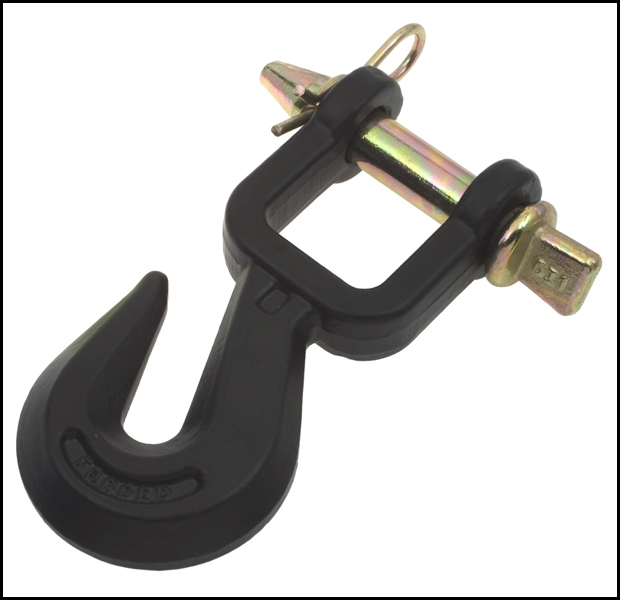

Get one of these for your drawbar:
Bruce

I have a clevis in the draw bar already. I just wanted to transfer some more weight to the back of the tractor to pull the trees out.
