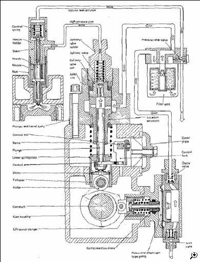

How is your hydraulic oil level? Do you have a loader attachment?
Here is a cross sectional view of a typical inline fuel injection pump.
I filled it all the way up when i changed all the fluids, ill have to check it again! Are you suggesting that the HDY oil maybe leaking out the pump and into the engine oil?
