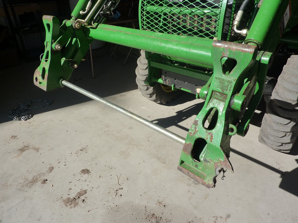

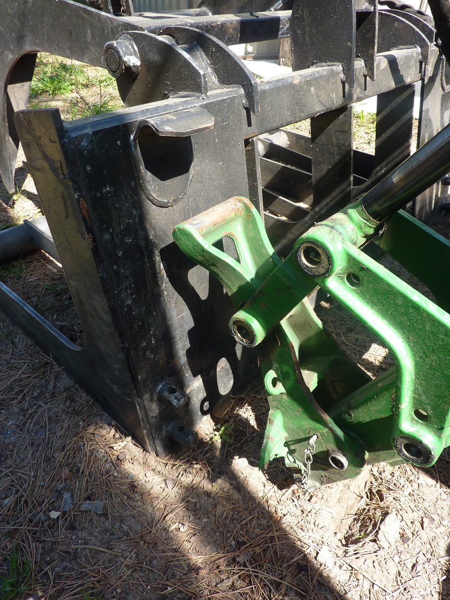

Heres a pic of the broken part (the casting). The "U" shaped saddles on the grapple are strectched and the pin on the grapple is bent and the hole in the pin is elongated. :confused2: I was using it hard.....but that's sometimes what you do with grapples. yikes. :mad:

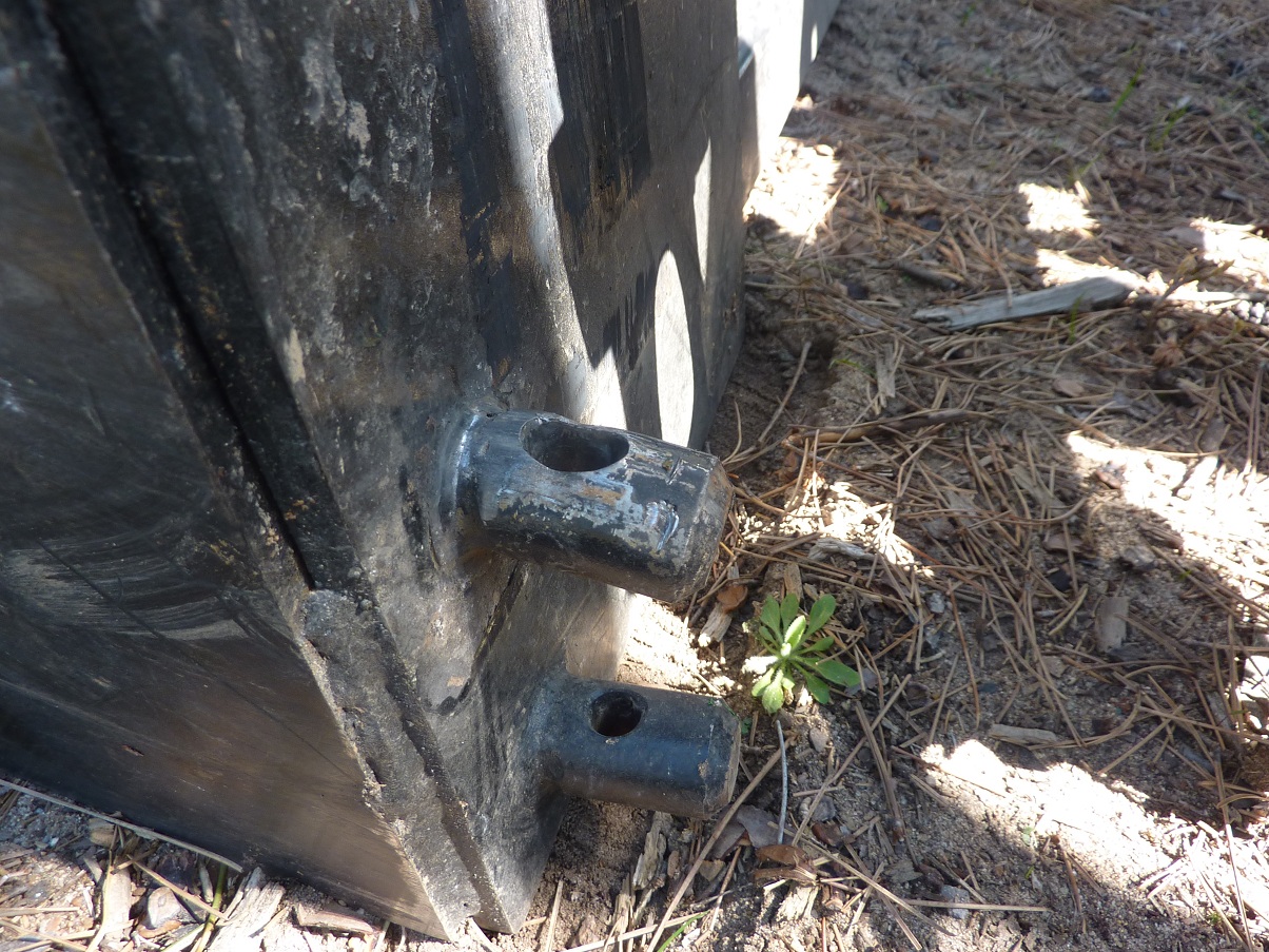

Heres a closeup of the pin in the grapple. I cannot beleive I did this. :confused2:

Thanks smalltown!! The part price is not as bad as I thought it may be. My Dealer is Northland JD in Brainerd MN. They have a couple of stores. I will call him to get one coming in the morning.
The part can be replaced.....the grapple is gonna take a little re-engineering job. I suggest if anyone has a Gator (Markham) grapple that you add some gussets to the U connector - just like JD does on their buckets. (and save yourself some greif and $$) Mine are streched pretty bad. :(

WOW! My grapple has the super heavy-duty top hooks and not the bent steel ones like in your picture. Was yours bought after the Markham's sold?
   / I broke a part on my loader
Yeah, mine was bought after Markhams had sold (but they had not yet told anyone they sold).
I thought about this last nite....and it's really annoying that those hooks streched....which caused the problems. I wish I would notice stuff like this sooner. :( I got a hunch there will be more folks with this problem.

Yeah it does suck. I can see the top hook opening up-but bending that pin is almost unbelievable! That thing is like 1 1/8" or so!
