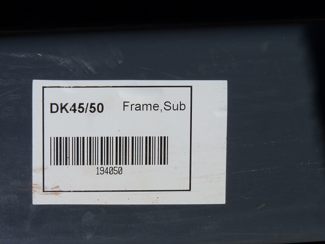

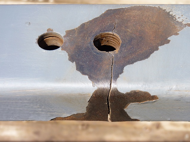

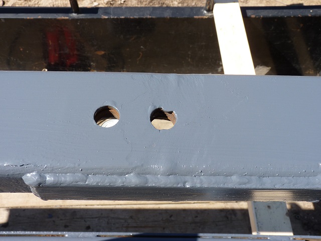

DK45/50 backhoe subframe. I guess the hydraulics are stronger than the steel.
The local machine shop came to the rescue again. They welded the crack area and added reinforcement plates to both sides in less than an hour.

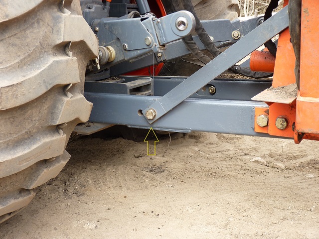

Where is that on the subframe, I have a DK40SE and hoe, I might take a look and inspect my subframe.

The crack was right below the angle brace bolt. Picture attached.
Paulfun9:
Your are so right. Those bolts keep coming loose, but I think the operator (me) is to blame for the crack. On multiple occasions I would start digging with the boom and dipper stick fully extended. I'm surprised it didn't crack sooner.
