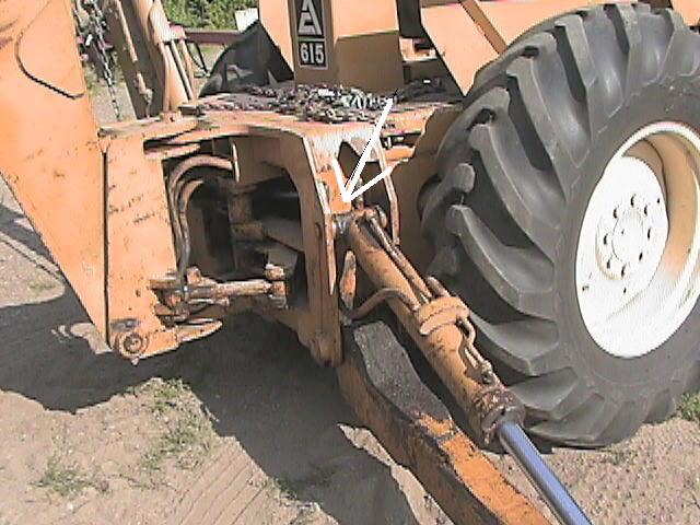

I had a cylinder fatigue crack last Summer. Took whole tractor to a local Blacksmiths (Welding shop) Unscrew the hyd hoses - welding heat builds pressure - and let a pro weld the crack.
15 mins at his shop and $15.
A new cylinder was $700, Industrial TLB and difficult to remove.
Works good as new.

   / I broke the hydraulic inlet to my 410 FEL #8
</font><font color="blue" class="small">( i broke the female port right at the seam where it joins the cylinder.
if i choose to weld it (my father-in-law has a welder) do i have to take it off the FEL to weld it? Do I want to disconnect the hydraulic quick connects from the tractor to the FEL before doing any work on the leak?
thanks )</font>
Definitely take it off the tractor, I also would take the rod out of the cylinder( you need a little plastic "tool" to do this) to make sure that (1) you can clean the inside of hydraulic oil so as not to contaminate the weld, and (2) to make sure no slag or drips of metal fall into the hole and wreck the seals or damage the piston making a somewhat bad situation worse.
I would really suggest you take the cylinder off the tractor, that is very to do with minimal tools, and take the unit to a local hydraulic shop for this repair. It will be much cheaper than a new cylinder.
