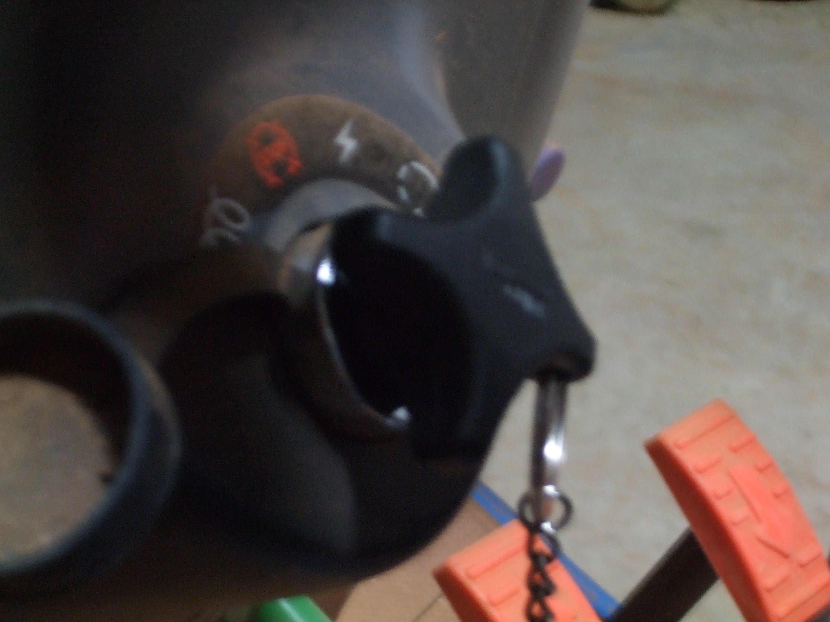

I was getting off my tractor (xj2025h) Saturday and hit the ignition key with my knee and bent it over pretty badly. I had hit the key before with my knee and bent it slightly and was able to straighten it out. When I tried to bend it back it Saturday it snapped off.

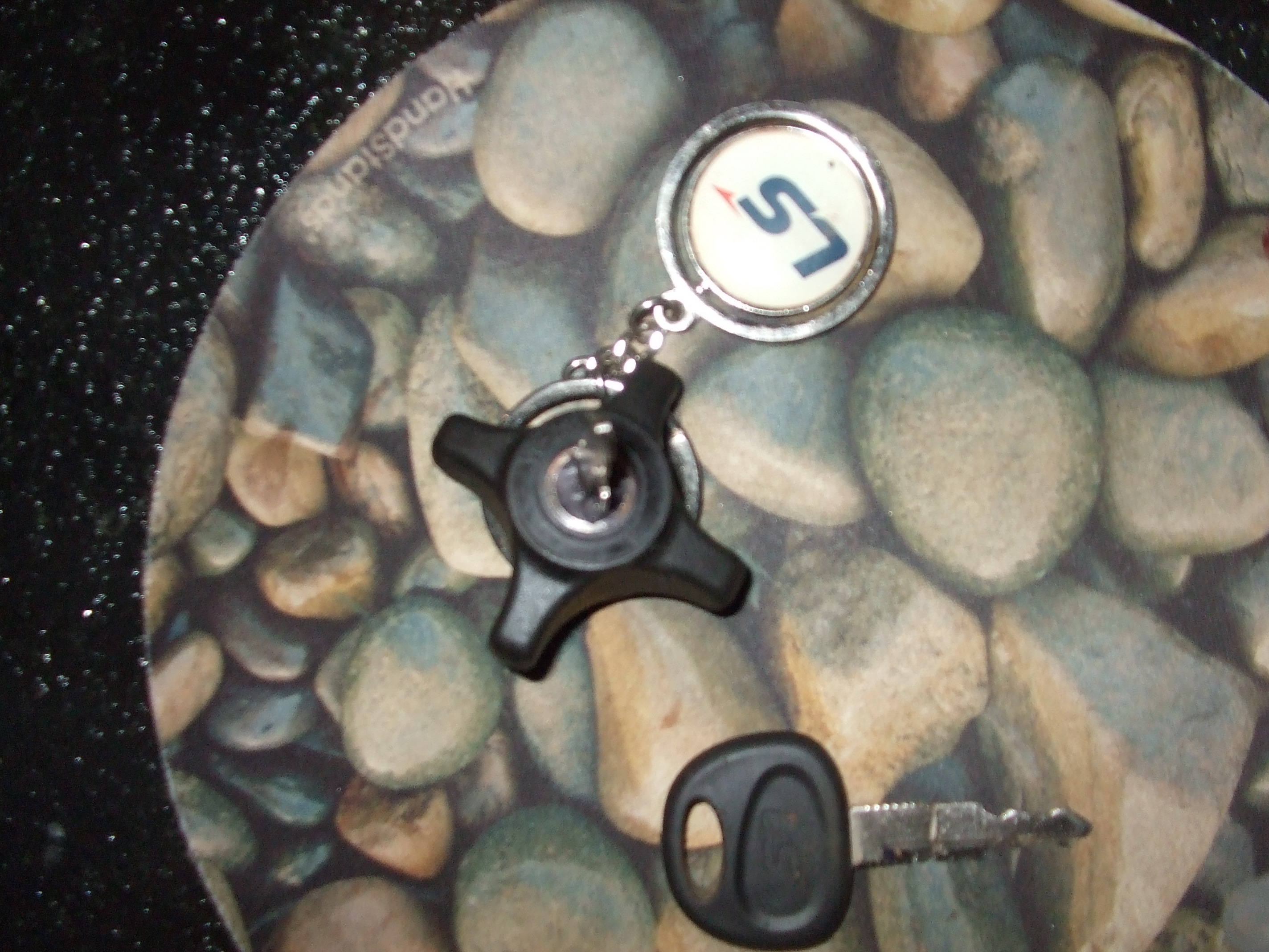

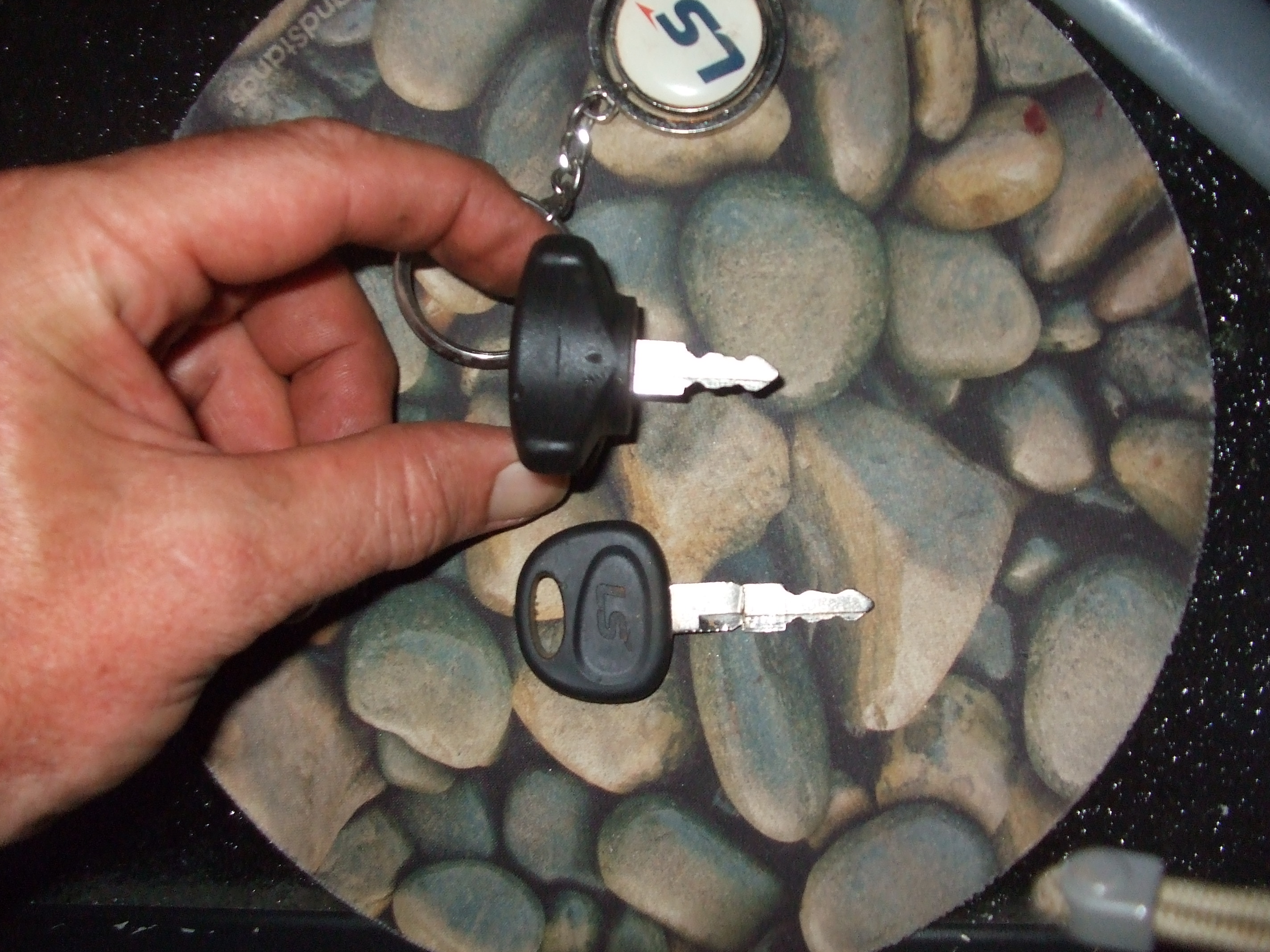

LS just put the key in a bad location and the key sticks to far out of the ignition. I suspect I'm not the first person this has happened to. Below is what I did to my spare key to try to modify it so this would not happen again.
I had a knob from an obsolete piece of automation that we scrapped out at work. The knob had a 10x 1.5 mm steel threaded insert in it which just happened to be slightly smaller than the width of the key.
I put my spare key in the ignition and marked it with a magic marker, so I would know how much of the key I would need to leave sticking out. I then cut my spare key off just under the plastic head of the key and slightly tapered the end I had cut off on my disc sander, so I would have a lead in when screwing the knob onto the end of the key. (I had tested this on the broken end of the old key before cutting up my spare key). I then chucked up the cutoff spare key in the vise on my mill and then screwed the knb onto the shank of the key. I then mixed up some JB Weld and filled in the area between the shank of the key and the threads of the insert. I even drilled a hole in it for my key chain. Below are pic's of the finished product. I'm happy with how it turned out.

Strange that LS would design their key(s) to originally fit like that... an accident waiting to happen. My JD keys are short & squat = no danger of whacking them.

That is a very crafty solution. Closer to the dash and much easier to turn.

Broke mine off within a week of owning it. Took the stub and soldered it to two brass flat washers. It is completely flush with the dash now.

Broke my key off leaving about an eighth of an inch in the plastic fob; soldered the two together with the fob at 90* to the toothed section. It sits flush with the face of the switch, causing no more trouble

I was hitting my key with my knee and bending it when getting off the tractor. I had a new one made at the local Farmer's Co-op, and it has a much shorter bow (head), so I don't hit it.
