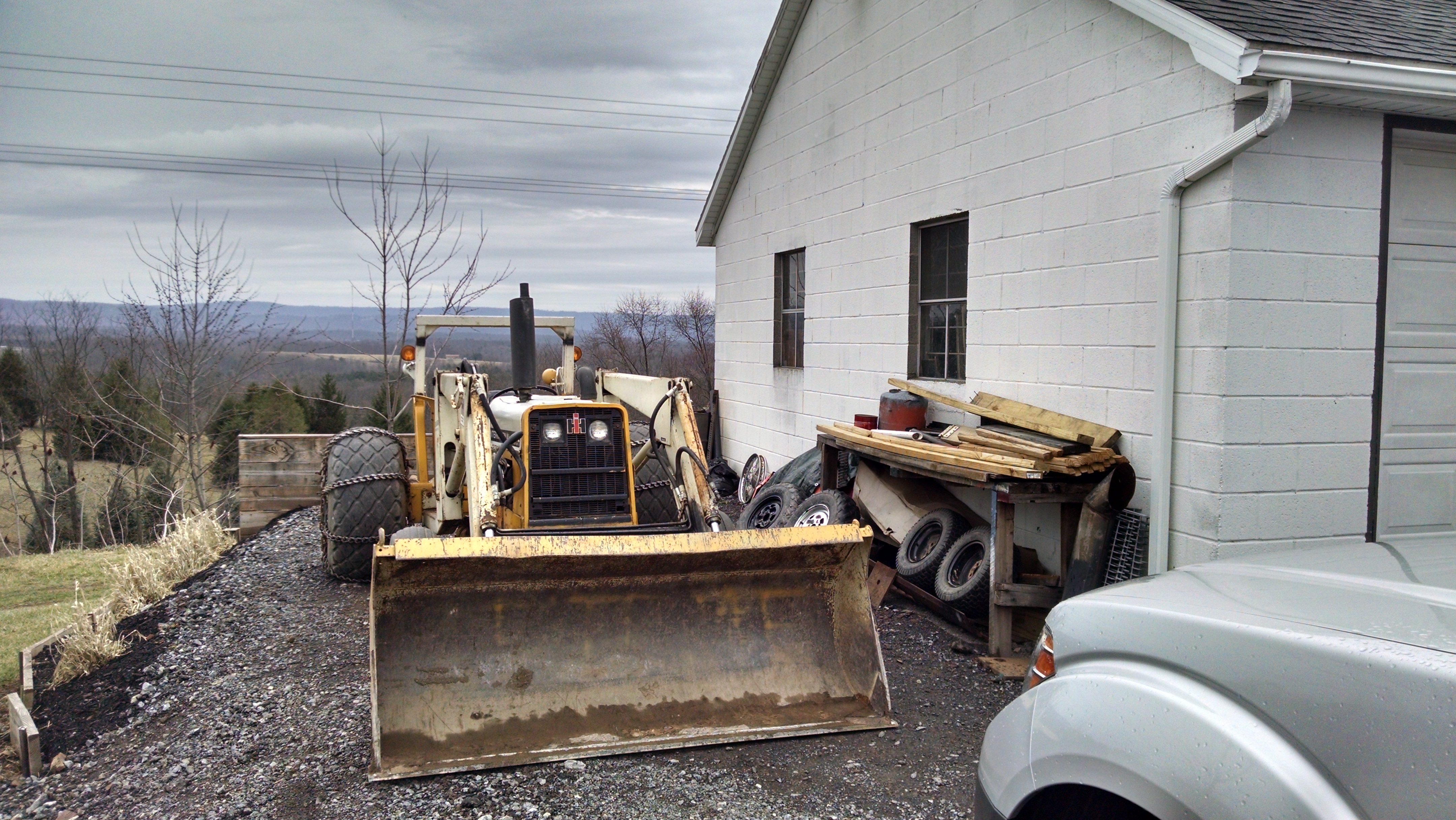

Okay, how's this? Look familiar?

   / I can use a bit of advice #9
There ya' go...!! As near as I can figure, just looking at pictures, it appears to be a 240A Industrial version. The front axle gave it away... If you look on the ID tag, I'm guessing it may possibly say "Made in England."
Here is a link to Tractor Data: TractorData.com International Harvester 240A industrial tractor information
Click on the picture to enlarge. The grill looks the same, and does have the side frame like yours.

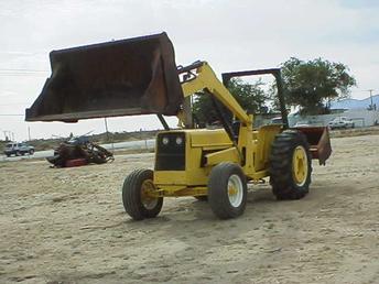

Those 240A's were designed for a loader, and backhoe for that matter. HD non-adjustable front axle, and the side frame to relieve the stress off the engine block, and torque tube.
The IH 2050 loader is the perfect fit for this tractor. Finding one, is another story.
I've attached a picture of a 240A with loader.
Some rear ballast will be a must. I had one of these loaders on a IH 2404 Lo-Boy, and had a 6' Massey-Ferguson rotary cutter on the rear. I thought it would give it plenty of ballast... Nope... So loading the tires, + extra weight on the the 3 pt. might be a good idea.
