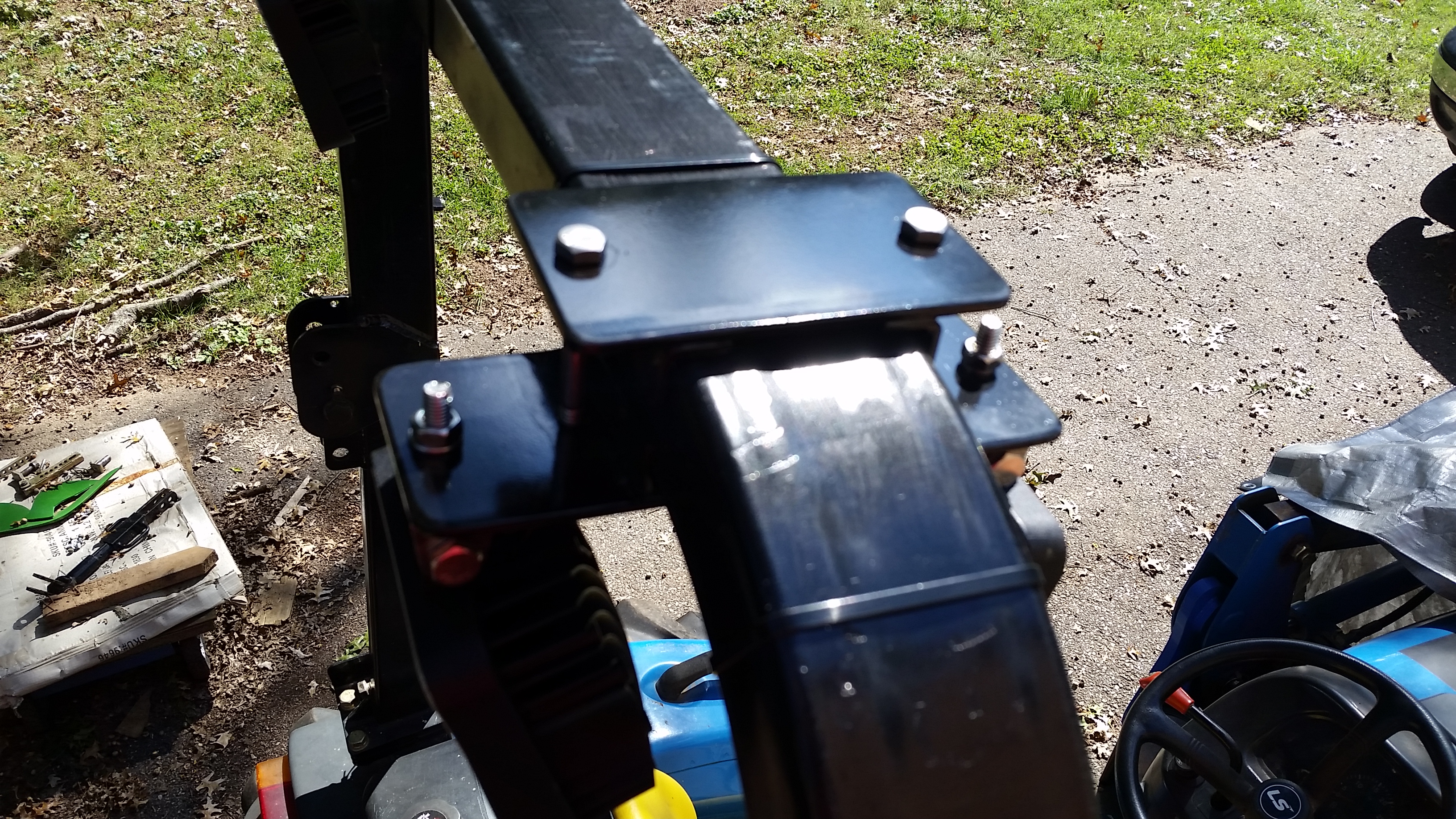

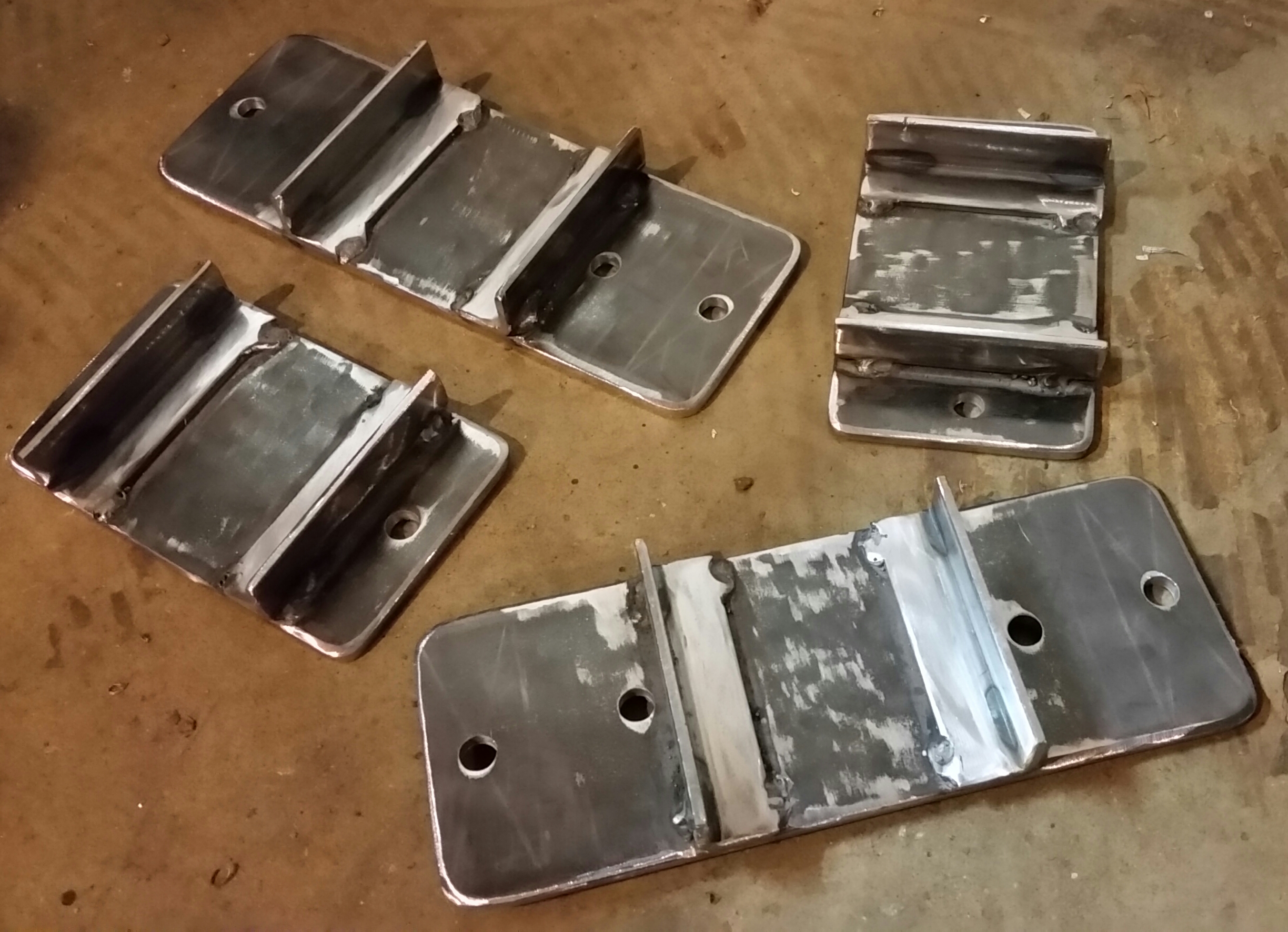

... but I didn't use any high speed space age materials like he did ... I went old school and fabed up some brackets that clamp to the ROPS:
Raw:

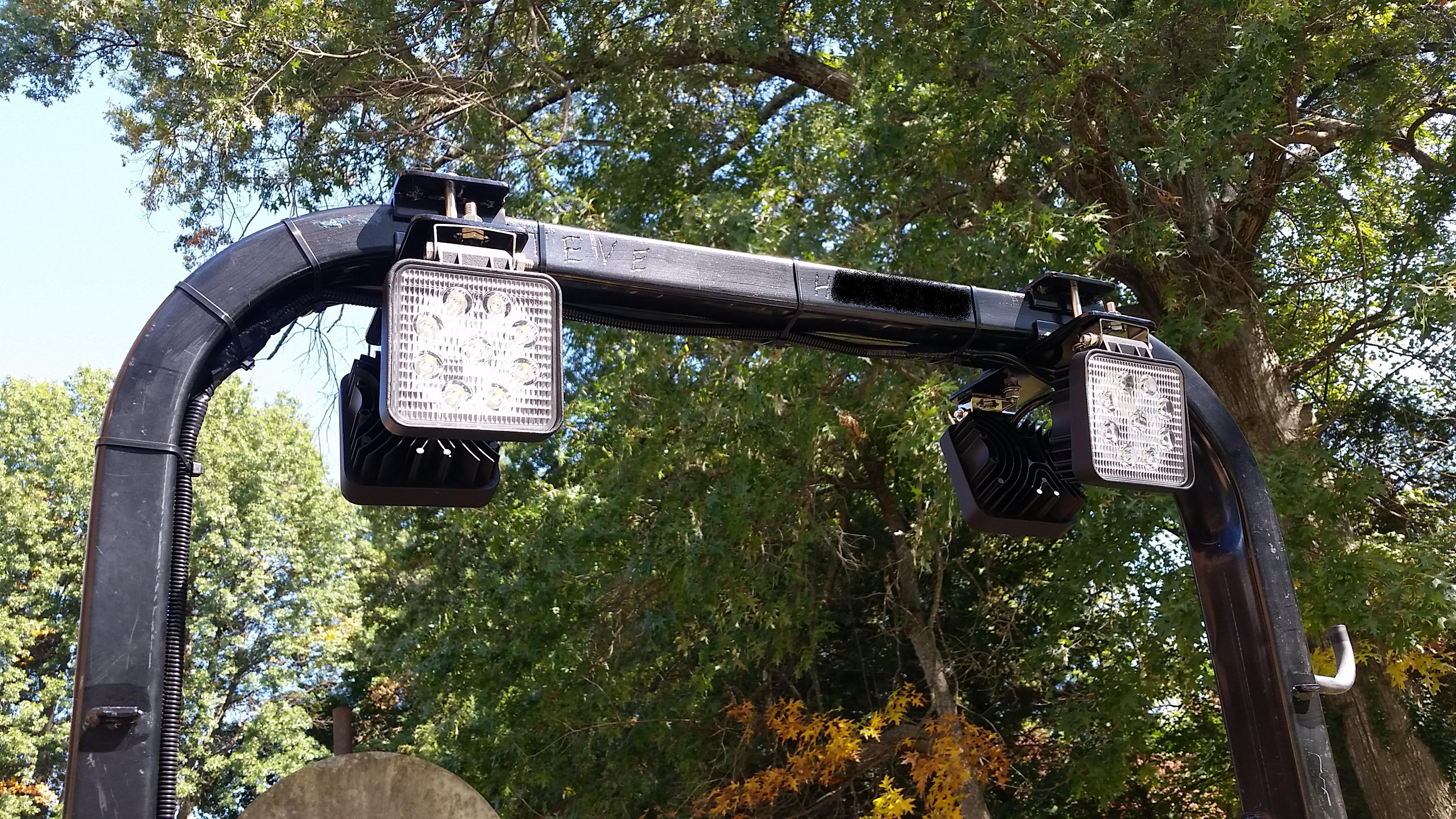

I did use the same Tuff LED lights that he used from the same Amazon link:

Lights installed on ROPs:

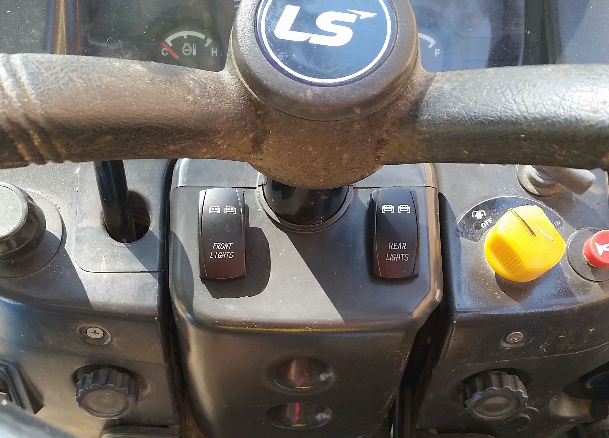

There are a ton of these switches on Amazon that are back lit in different LED colors and are etched with various graphics and text. I found some that said "front lights" and "rear lights". When the switch is on, the bottom and top LED's are on and illuminate the text or graphics. Here's a shot of my dash lit up with the LED's off so just the text is illuminated in blue LED (which looks white in the photo):
Example of the kind of switches with text/graphics you can find:
Amazon.com: MICTUNING Momentary LASER Rocker Switch WINCH IN/OUT, On-Off-On, 2 Amp 12V LED Light, 7pin, BLUE: Automotive
One challenge was the dash of my tractor is curved .... no flat spots to put the switches! So I used the flat spots on the plastic around the tilt steering. I needed to adjust my tilt steering lock (wasn't holding wheel where I wanted it very well - which was fun) anyway so it was a win win!
Here's a shot of the switches installed (in daylight):

Nice work! I'm going to have to do something similar, as it's getting dark early, and I have work to get done... I replaced the non-functional headlights in my tractor with some 3x5" LED units. They work OK for the sake of having lights, but are more of a spot light than a work light... Plus they shine through two box-holes in the loader frame, which doesn't help. Time for some work lights on the ROPS. :)
Just curious, does having the lights behind you, and facing forward make for any glare or nasty shadows while you're operating? I had planned to build a canopy, and put them one the front of the canopy, but if they're fine on the ROPS, I might skip the canopy for now...

I have plans to do a canopy too (and a cab at some point) so that's one reason I made metal brackets for the ROPs as I figure those can get reused for the canopy down the road. I was worried I'd bang my head on the lights (which is why I curved the corners) and also being blinded getting on the tractor. Turns out the lights are high enough and out of the way that I won't bang my head on them unless I'm doing something crazy and as long as you don't look directly at the lights while getting on the tractor it doesn't blind you. It's kind of surreal as it lights up the cabin workspace area. You're lit up and so is the tractor. If you drop something off the side ... no problem seeing it. I was blown away by the difference it made and wondered why it took me so long to get around to doing it.
No real shadows that I've noticed so far ... everything is lit up pretty well. I guess if I focused them down where the beam hit the tractor it might glare of shiny tractor surfaces but I have them adjusted to light up just in front of the tractor for doing loader work (or bush hogging so I don't run over something).
These lights are perfect for work lights. I'll be doing some backhoe work with them soon (hopefully) and will maybe post more pictures.
