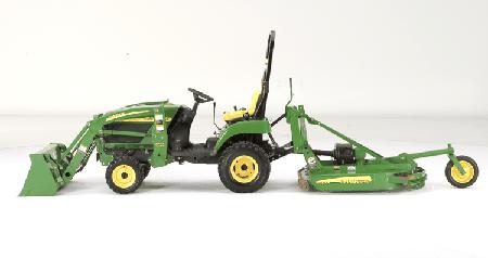

Hmmmmmmmmmm - what is the FEL load capacity of the 4115 ? I can't find the answer on Deere's web site ...
thanks
   / I can't decide! 4110, 3120 or 4310 #6
Re: I can\'t decide! 4110, 3120 or 4310
410 Loader
49 In. (1250 mm) Materials Bucket
Quik-Tatch Parking
Quik-Change Attachment
Mounting Frame
Hood Guard
Specifications Meet ASAE301.3
Specifications (4100,4110):
Lift Capacity: 800 Lbs. (363 kg)
Breakout @ Pivot: 2130 Lbs. (9475 N)
Lift Height: 74 In. (1880 mm)
Rollback Angle: 25 Degrees
Dump Angle: 45 Degrees
200X Loader
Specifications Per ASAE 301.3
Measured @ Pivot Pin:
Lift Capacity 562 Lbs. (255 kg)
Lift Height 73.4 In. (1865 mm)
Boom Breakout 1513 Lbf. (6730 N)
Dump Angle - 39 Degrees
Rollback Angle - 31 Degrees
Quik-Tatch Carrier
Mounting Frame
Hood Guard
49 In. (1250 mm) Material Bucket
200CX Loader
Lift Capacity 800 Lbs. (363 kg)
Lift Height 78.7 In. (2000 mm)
Boom Breakout 2137 Lbf. (9510 N)
Dump Angle - 38 Degrees
Rollback Angle - 25 Degrees
Quik-Tatch Parking
Quik-Tatch Carrier
Mounting Frame
Hood Guard
Bucket Level Indicator
53 In. (1350 mm) Material Bucket
