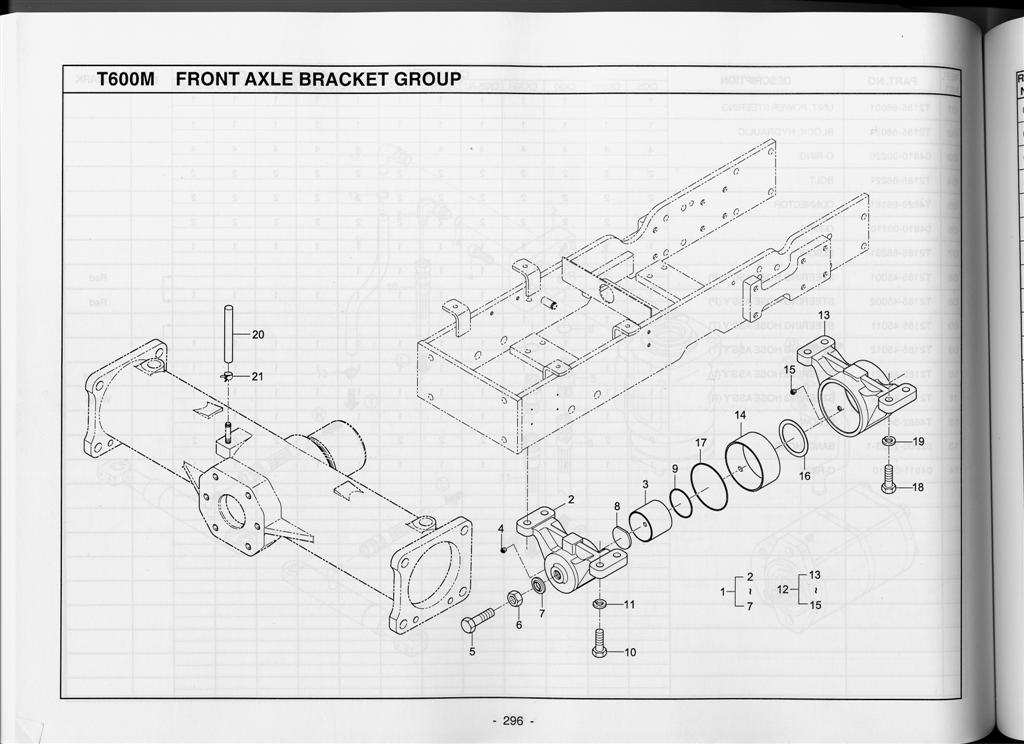

Try to get grease into the blasted fittings on the front axel bracket group. There are two fittings labeled 4 & 15 in the accompanying illustration that need to be greased. When I attempt to do so neither will accept any. When I unscrew the fittings there is grease present in the joint and I can easily push grease through the fittings while they are out. When reinstalled though nothing move in and the grease will eventually push out from the grease gun / fitting connection. I do not see any grease emanating from any of the machined surface that makes up the assembly. Any insight as to how to get this connection greased and where the overflow grease should be seen would be appreciated.

   / I can't get no satisfaction! #2
They are a pain in the butt...
Try putting the loader on the ground and push the front wheels off the ground and pump grease into the grease fittings as you pivot the axel.
   / I can't get no satisfaction! #3
Just as Wallace suggested. I had the same problem you are having and lifting the wheels off the ground solved the problem.
   / I can't get no satisfaction! #4
Plus 3 to the others. I have the same issue. Apparently there is some positive pressure in these assemblies and that takes them of. Im guessing that this is air/water tight and when you lifit it up it changes that. Dunno but it works
   / I can't get no satisfaction! #5
Good to know! Thanks Rick!
I had not forced the issue, I had just thought they were full and didn't want to ruin any seals, will get to this asap!
Mike
   / I can't get no satisfaction! #6
Thanks for that post, I am having the same problem, will try with wheels off ground.

Thanks to all that replied, I tried the suggestion but still no success. :mad: The front end is very tight and does not rock back and forth very easily. Since there is presently grease in the joints and it does not appear to be exiting anyplace I can detect, I am going to just ignore this until the next time I do a lubrication. Hopefully as it wears in (200hrs now) this will improve. I may try on the next lubrication to see if I remove one grease fitting and lubricate the other if the grease will work its way completely through the joint, although it wouldn稚 seem that they would put one on each end if it was open completely through.
