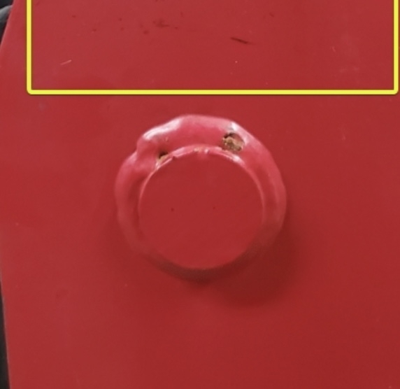

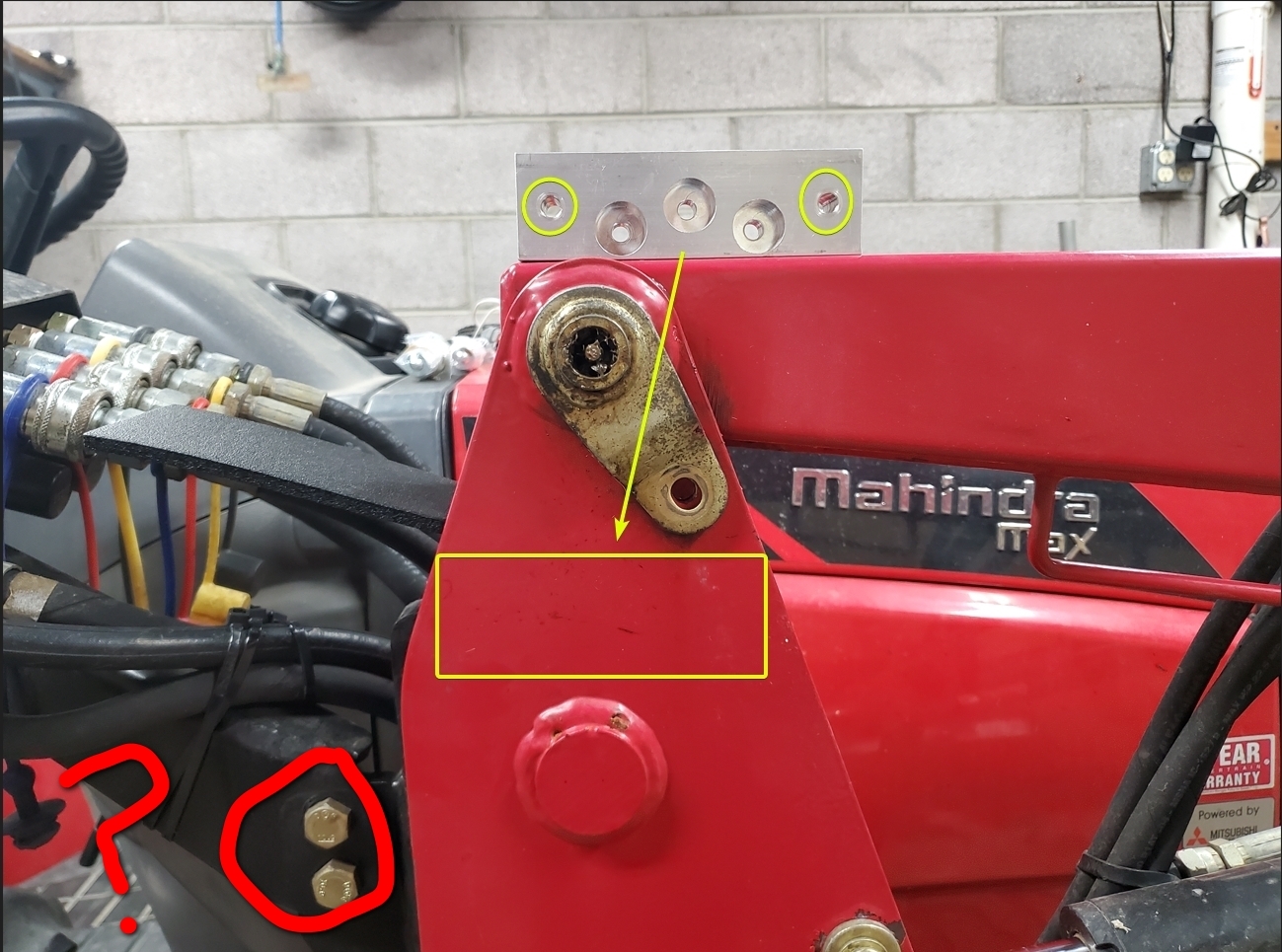

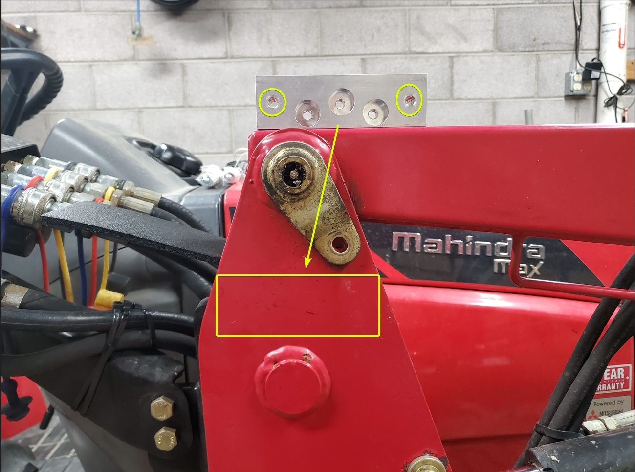

I bought a diverter valve kit for my mahindra, it requires drilling a mount bracket into the loader support bracket, this bothers me, even though there are holes already in it. Am I worried about nothing, really would like someone who deals with stresses to tell me I am worried about nothing.
what else am I going to do? I have the ability to make a non penetrating mount via 3d printing and cad design, it will take me several hours of design, and some filament, but, I don't like to have 3d printers solve everything if there is literally no reason. and there are several negatives...
Can you guys calm my nerves, I don't plan to ever take it off, I bought a grapple, and need it terribly. photo's attached,
Ignore the missing bolt, it was taken out for the design of the non penetrating.

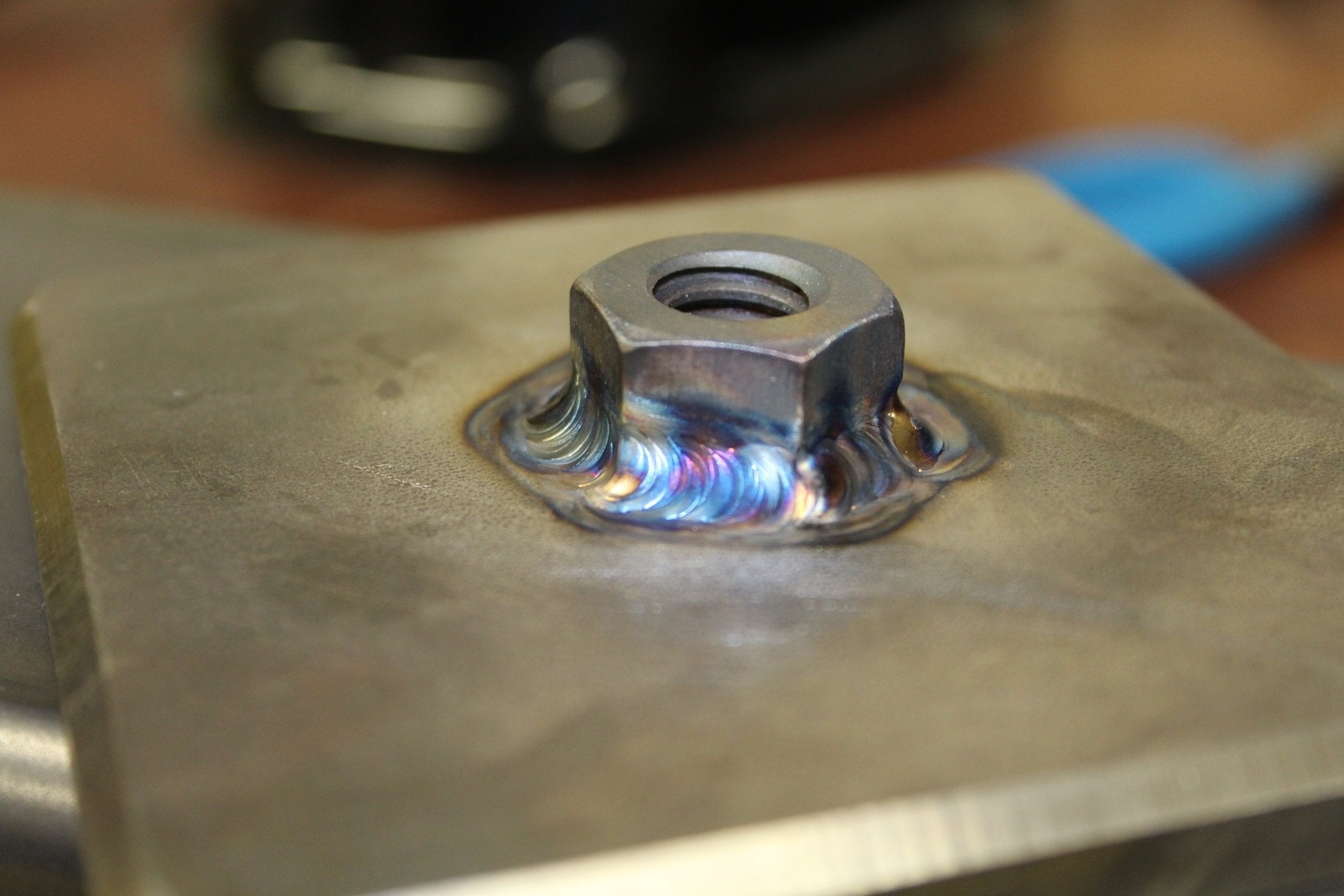

If it were mine, I would tack weld some nuts on the plate steel and attach with short bolts. If you don't like that, you could also mount the bracket to a longer backing plate to make a clamping solution around the loader arm.
The area you indicate sees quite a bit of stress and personally I wouldn't be interested in weakening that with holes, but without a finite element analysis we are guessing whether or not it will make a real world difference
There are 2 holes already from the factory for the pin restraint, that said your nut idea would be an ok idea, but that circular bar, forces me to be raised above a normal nut height to clear the diverter

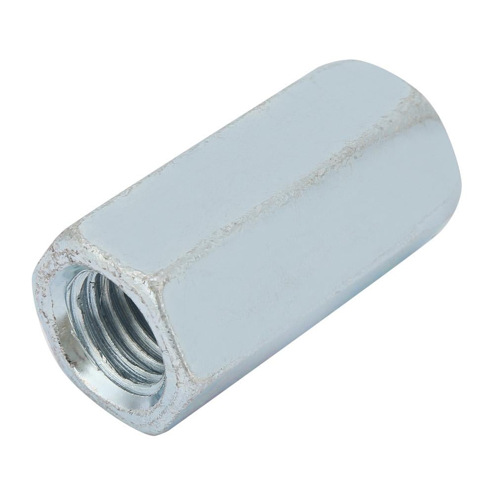

This might be an option: allows more thread engagement as well

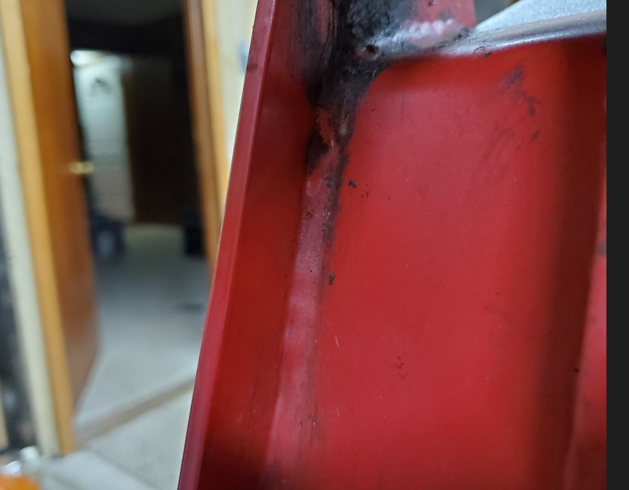

Looks like the Mahindra welder used rusty coat hangers as welding rod.
I would suggest re-thinking your mount points before drilling your loader tower. Use small screws if you do i.e. 8-32 or 10-32 and keep holes on the middle of the structure

Could you make a bracket to attach it to the area where there are two bolts already?
