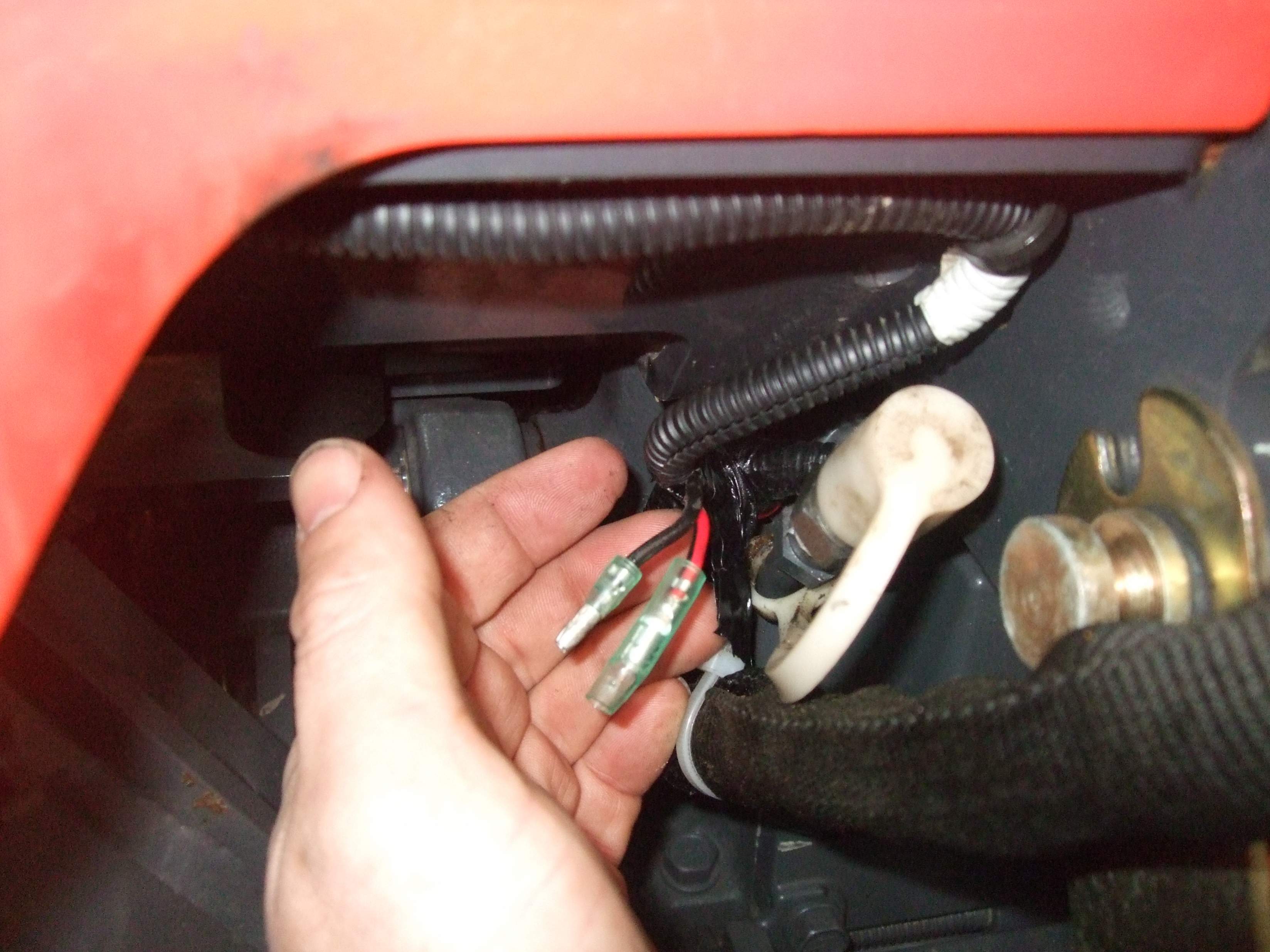

I bought the BXpanded work lights and I can't find the connectors that are suppose to be behind the left tail light on the bx23. I opened up the conduit that the wires are in and as far as my fingers can go I can't find the connectors. I'm thinking they are in the harness where the 2 wires for the taillights and the 4 wires for the blinkers and flashers are. I can't imagine where else they can be without taking off the fenders. I've heard they are hard to find, but this is frustrating.
Any help?
Thanks

On my 1850, mine connection was just to the left of the top link connection.

The connection is as pictured on my BX 2360, they maybe taped. so they should be in the same location. good luck.
   / I give up Can't find work lights wires bx23 #4
That picture is right where I found them on my bx 2360.They was taped over so they was a little hard to find at first.
   / I give up Can't find work lights wires bx23 #5
I posted about this before. I am hoping your BX23 is exactly same as BX24. What you do is follow wire loom from tailight until it meets the main harness where it forms a Y. You will need to dig in there and root around all the wiring. Mine was taped over with black eletrical tape in a way that you would have never guessed its there unless you start removing the tape in the Y around of wire harness. When I was looking for the wire before, posts here said the wire connections were under the seat . The BX24 and up seems to be directly in backlike in my pic.

I found it. They were taped almost underneath the fuel tank. I was looking by the left rear tailight. The were a couple of "Y" intersections and I followed the wrong one. Thanks for the replies
