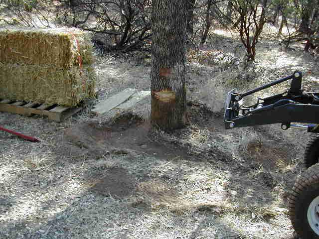

The first time I've had to call out the pickup and tow strap. No amount of wiggling would help. The slope is a little steeper than it seems from the photo....
On the other hand, I had fun this weekend "working" with my new grapple bucket and box scraper.
Phil

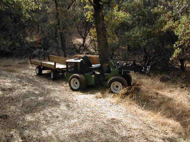

A photo from the other side, not as clear tho.
Phil

   / I got my PT stuck! #3
What a coincidence! While browsing either this or some other forum a couple of days ago I came across a posting where someone asked about articulated tractors like the PT, and somone else responded that one of the problems with articulated tractors is that if you get too close to something like a wall (in your case, a tree) you could get stuck making the machines not that ideal for those who often work close to obstacles (like walls). I'm thinking those folks in the landscaping and grounds maintenance professions.
Thanks for proving it! /forums/images/graemlins/wink.gif

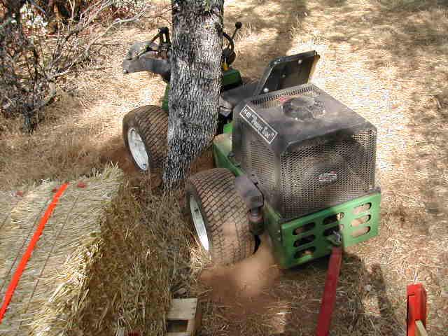

Kinda scraped up my green guy, but not as bad as the tree.
Phil

   / I got my PT stuck! #7
Some of you all correct me if I’m wrong but there is a maneuver that will get you out of a situation like that but you need an attachment in the front to do it. In your case you would cut the tractor all the way to the right then push down with the front end lift, lifting the front wheels off the ground. With the front wheels off the ground cut the tractor to the left. Let the wheels back down, lift the attachment off the ground and repeat until the tractor is away form the tree. This maneuver can come in handy in a lot of places. But I see you didn’t have that attachment in the front so you may have already known this. Will the tree live? LOL /forums/images/graemlins/blush.gif

   / I got my PT stuck! #9
<font color="red"> push down with the front end lift, lifting the front wheels off the ground. </font>
That's the type of manuver i use. I've got lots of trees on my place and it's easy to slip up against a tree on a side hill. I put what ever attachment is on the front, on the ground and while the fronts wheels are up, i turn the pt one way other the other depending on which side i have the tree. After a while you get pretty good /forums/images/graemlins/frown.gif
   / I got my PT stuck! #10
You are tight about that maneuver to get unstuck. A big log would have worked, or ever that cart. Just put the lift ends on the cart, and raise the front end and wiggle to the right move the lift arms and wiggle to the left. One might have been able to pull the cart enough to free the PT. You might even try and practice this so it will be easy for the operator the next time.
   / I got my PT stuck! #12
Someone eles had a good suggestion when stuck on the uphill side of a tree like that... they said to drive around to the downhill side of the tree, if possible, and then do the wiggle. The tractor will slide down the hill, away from the tree.
Which one of you came up with that solution, anyway?
The other alternative was a chainsaw. /forums/images/graemlins/shocked.gif
#15
There was NO "driving around to the downhill side of the tree". It was lodged well. I could've brought an implement down and installed it, and maybe worked my way out but it was pretty easy to hook the snatch strap to the rear hitch pin and pull the back of the PT away from the tree. Anything else would've been more work and the same trip to get the pickup and come back. /forums/images/graemlins/blush.gif

   / I got my PT stuck! #16
I like to always have an attachment on the front for this purpose. The minihoe is the best. I did get stuck like this with a slope towards the tree. I used the come along to pull each end out a little at a time. I did not know about the PT "squirm" (my name for it) at the time.

   / I got my PT stuck! #18
Hmmm, I was just thinking... I always have a tow strap with me in a toolbox mounted on the engine cover. If you couldn't use the "PT crawl" method but had another tree close by I wonder if you could do this:
Steer fully in the opposite direction away from the tree. Attach strap to the front. Take it around the the tree and back to the rear. Then steer back toward the tree. Since your endpoints would be fixed the middle should swing away from the sticking point. Haven't ever tried this but it sounds like it should work...
   / I got my PT stuck! #19
I'd think if the straps were around different trees uphill of the stuck tracotr, it would probably work. You may have to adjust two or three times, but is sounds good.
