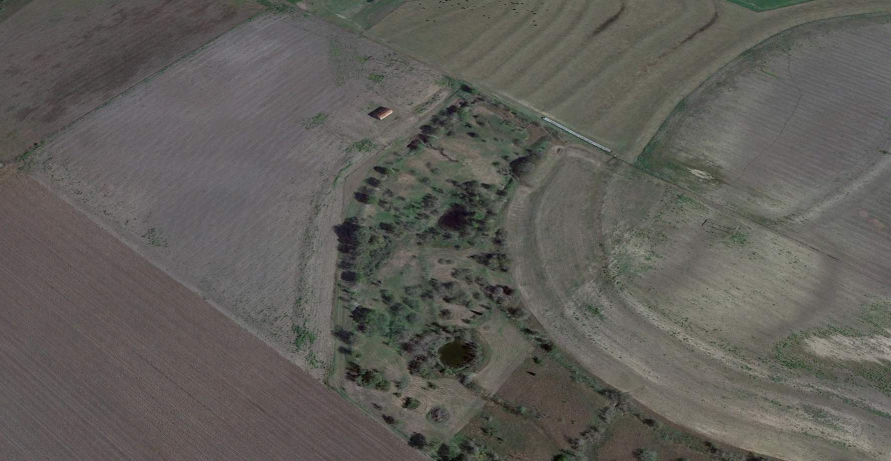

And a Kioti DK45SE HST tractor and a 7.5 ft wide disc.
Is it crazy to try and row crop that amount of acreage with with the Kioti and some kind of old seed drill?
I do not have the seed drill yet. Any recomendations on what size and/or model? I would not mind having to refurbish the drill assuming it would be reasonably reliable and not end up costing what a new drill would cost.
If an old/used seed drill is not advisable what is the most reasonably priced new drill?

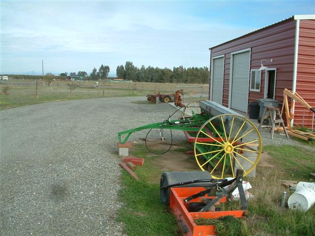

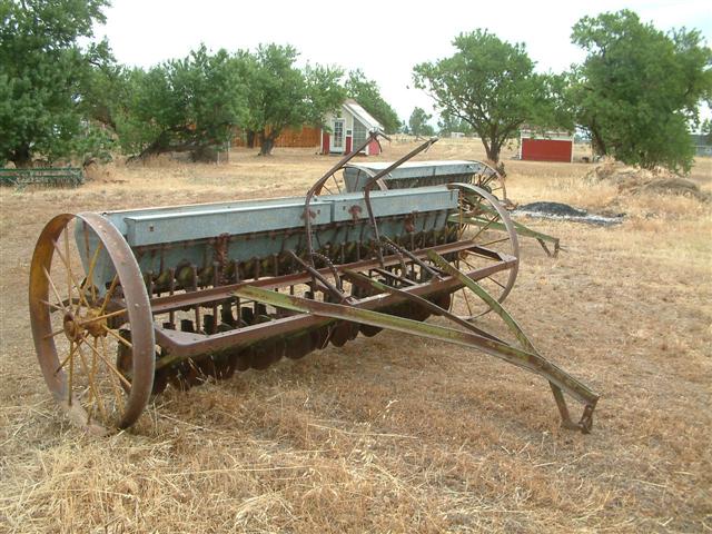

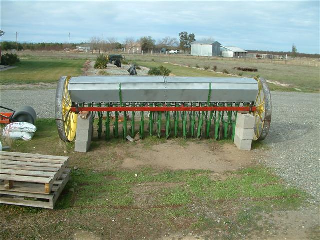

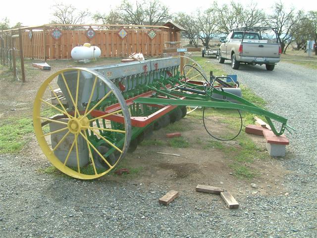

You can pay anywhere from a few hundred to a few thousand bucks for used drills. I bought a pair of old Minneapolis Moline P3-6 drills from a neighbor for $275 bucks (10 ft wide, 20 drops, 6 inch row spacing, single disc openers) with grass boxes. It took me about a month to rebuild one of these into working order using parts from both drills.

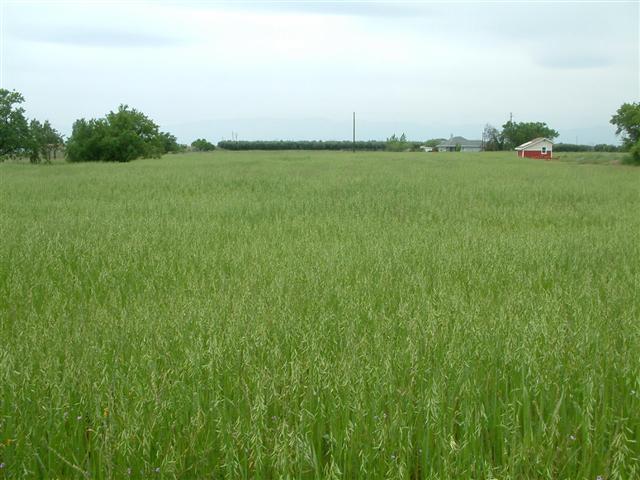

I only have 10 acres total. Last Nov I used the drill to plant 5 acres of Kanota oats. The job took about 2 hours. The drill worked fine.

Looks like you did a good job on the refurb. How many horse is your tractor? Does it pull the drill ok? Can you drill small seed like grass with it as well?
Nice job on the field!
View attachment 165955 View attachment 165956
   / I have a 25 acre field...... #7
That's a 2008 Mahindra 5525 (54 hp engine, 45 hp pto, 2WD, gear tranny), which is overkill for pulling that grain drill. I probably could have pulled the drill with my 1951 Farmall Super A with no problems, but that tractor isn't set up with rear hydraulics that I need for the drill (I added the hydraulic ram when I rebuilt the drill).
Yep, that MM drill has a pair of grass seed boxes attached to the front of the big box which is used for granular fertilizer and large seed crops like oats.
