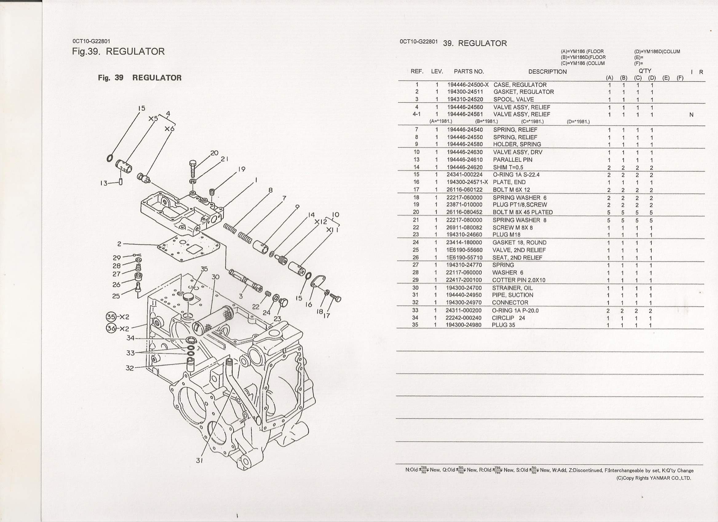

It's probably more like 3-5 seconds of delay, and the analogy of filling a tube to build pressure is what I pictured myself.
The fel and 3pt move instantly and the power shift delay is only for the first start of the day. The rest of the day no matter how many starts it never has the delay again.
It has fresh fluid, new filter and a clean screen.
   / i have a couple questions about power shift #9
I can go along with 3-5 seconds but in no way think Yanmar designed or itended a 5-10 second delay in cold weather. No matter, if it works fine after start up and serviced properly I would go for it.
The 186 is one of the models that has the suction strainer high up in the transmission with a pick up tube. I could see where fluid would or could drain back some and require a little more time to pick up. Maybe the 4220 has that design. I don't know.
