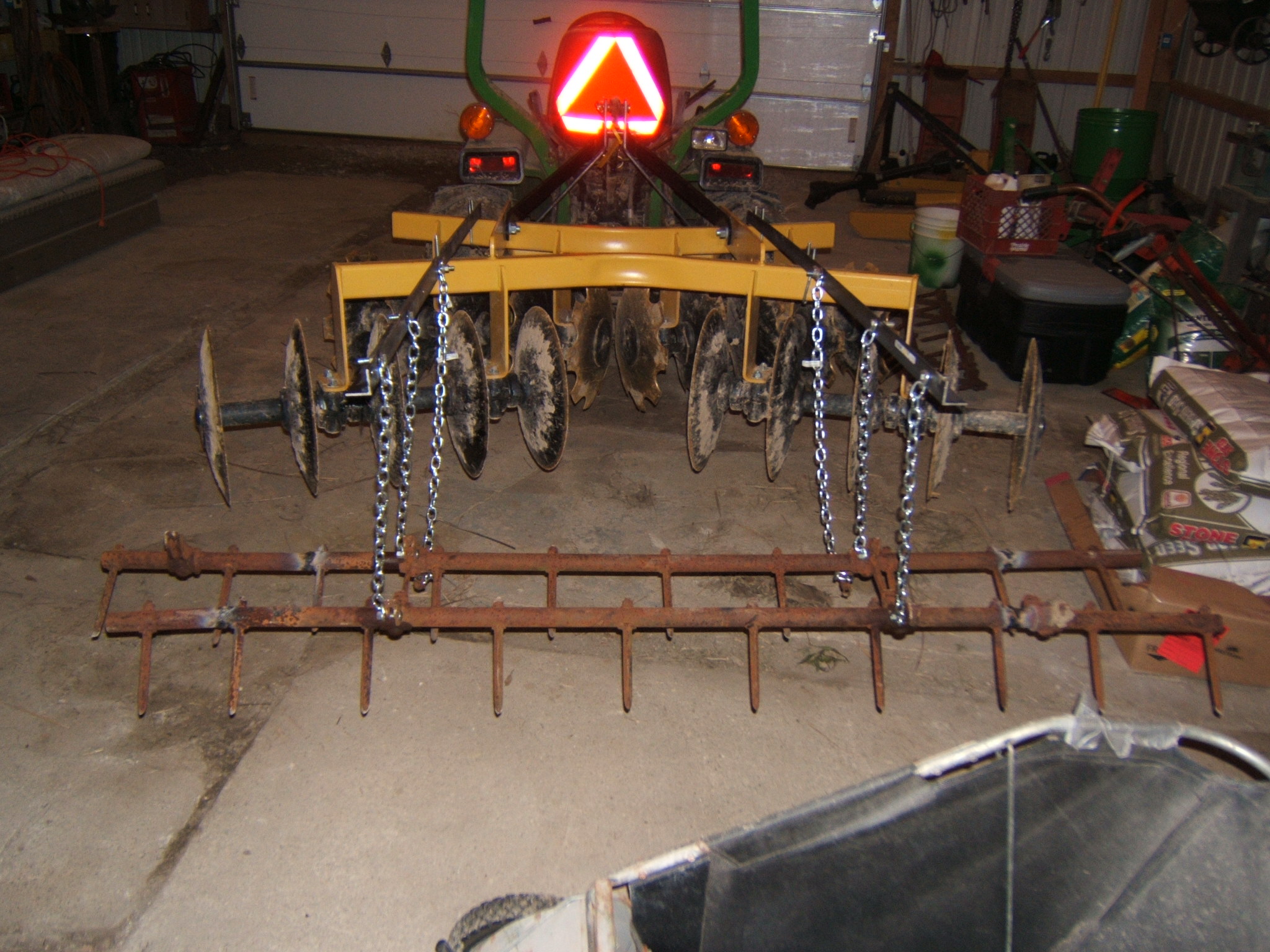

I mounted a 2 bar flex harrow on the back of my disk. I had an old 5 bar and cut it down to a 2 bar and added to the end of each section to make it wide enough to go behind the disk. I made mine 7 1/2 ft. wide behind a 6 1/2 ft. disk. I am planning on putting this one behind the 6 ft. field cultivator I picked up this summer and building another one 8 1/2 wide for the disk. Below are some photos of the harrow and disk. This did a real nice job of leveling up behind the disk.
