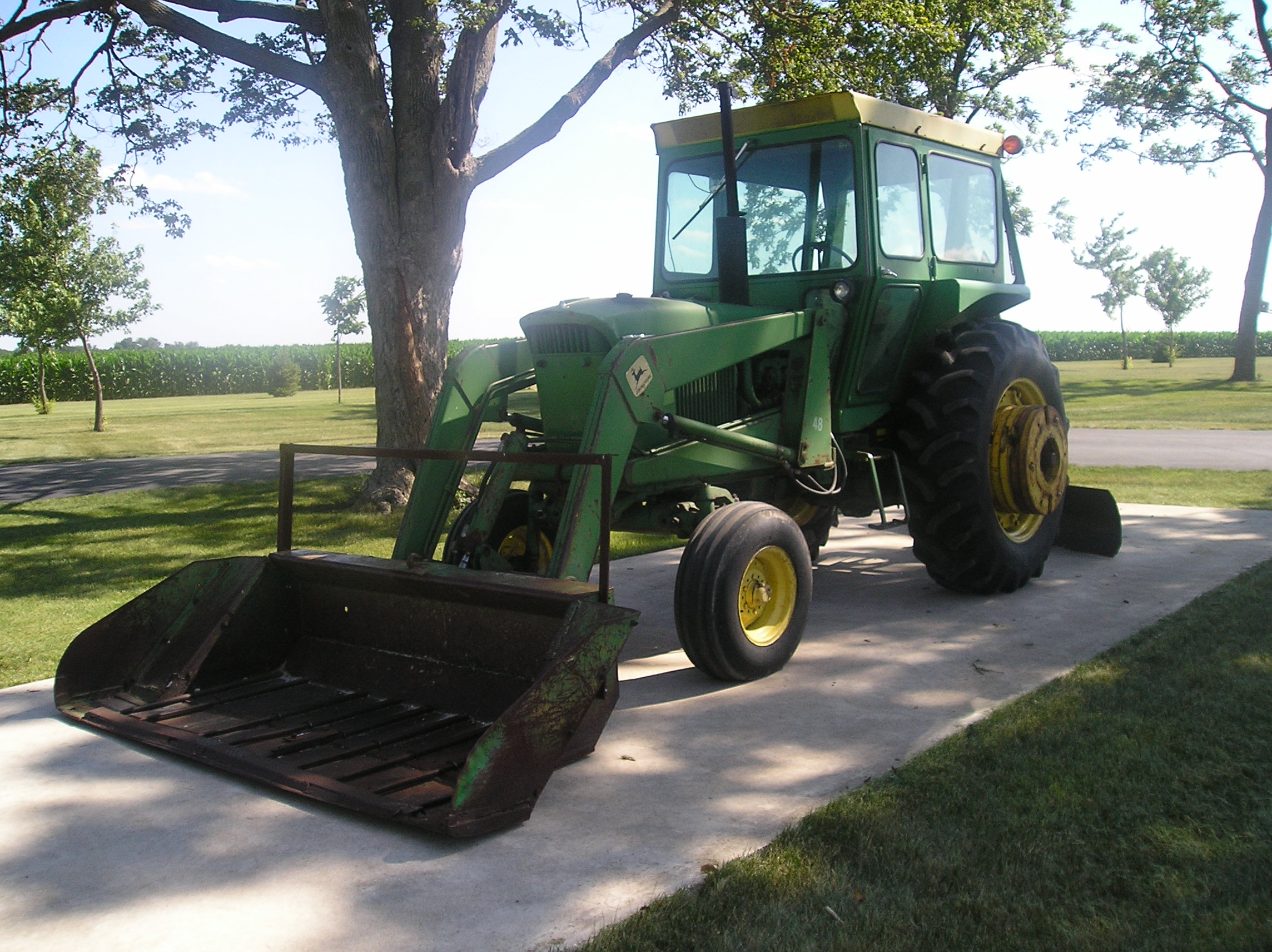

Deere made a 3-in-1 bucket. It was (1) a 6' materials bucket (2) a manure bucket with long bolt-on tines (3) an 8' snow bucket that slid under and into the tips the manure tines and bolted to the sides of the materials bucket.
It could handle wet snow very well.
The angle iron handrail is something I made up and bolted on.
