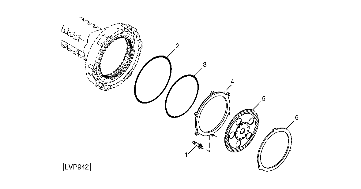

THIS TRACTOR HAS HYDRAULIC BRAKES THAT SEEM TO WANT TO DRAG ALL THE TIME. I HAVE CHANGED THE HYD FILTER AND FLUID AND EVEN BLED THE BRAKES. FOR SOME REASON THE BRAKES AREN'T RELEASING TOTALLY IN THE FINAL DRIVE ASSEMBLIES. THIS TRACTOR IS LIKE NEW AND ONLY HAS 260 HRS ON IT. DOES ANY ONE HAVE ANY SUGGESTIONS OR HAS HEARD OF THIS KIND OF PROBLEM THAT CAN POSSIBLY HELP? I DON'Y WANT TO PULL THE FINAL DRIVES IF I DON'T HAVE TO.

LVP942_________UN29MAY97.gifFirst, you need to be sure the brake pedals or the brake valve is not sticking and not allowing brakes to release. If that seems ok, then jack up the tractor and see if the wheel spins free. If it is dragging, loosen the bleed screw and see if it frees up. If it still drags with the bleed screw loose, then the problem is in the brakes. The final drives will need to come off. You might have defective retractor pins. They are #1 in the diagram. When reassembling the brake into the final drive, the retractor pins need to be pressed in until they bottom out.
   / I HAVE A JOHN DEERE 5103 TRACTOR WITH BRAKE ISSUES #4
I'll bet it's parts key #1. My neighbor had to R&R final drive housings on his 5310 for the same thing.
