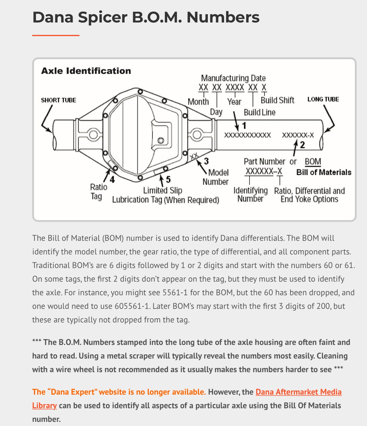

I have heard they were dana 44 diffs just wondering if that is right or not
   / I have a old swinger 100 with a diesel engine the differentials are going out on it was wondering where to get parts or what brand of diff's are in it #13
gears and bearings
If you could post photos of the diffs it may be possible it identify them, just looking around the Internet it looks like possibly a Dana 60 series but photos would help.

Dana 44 with 5.38 ratio gears
