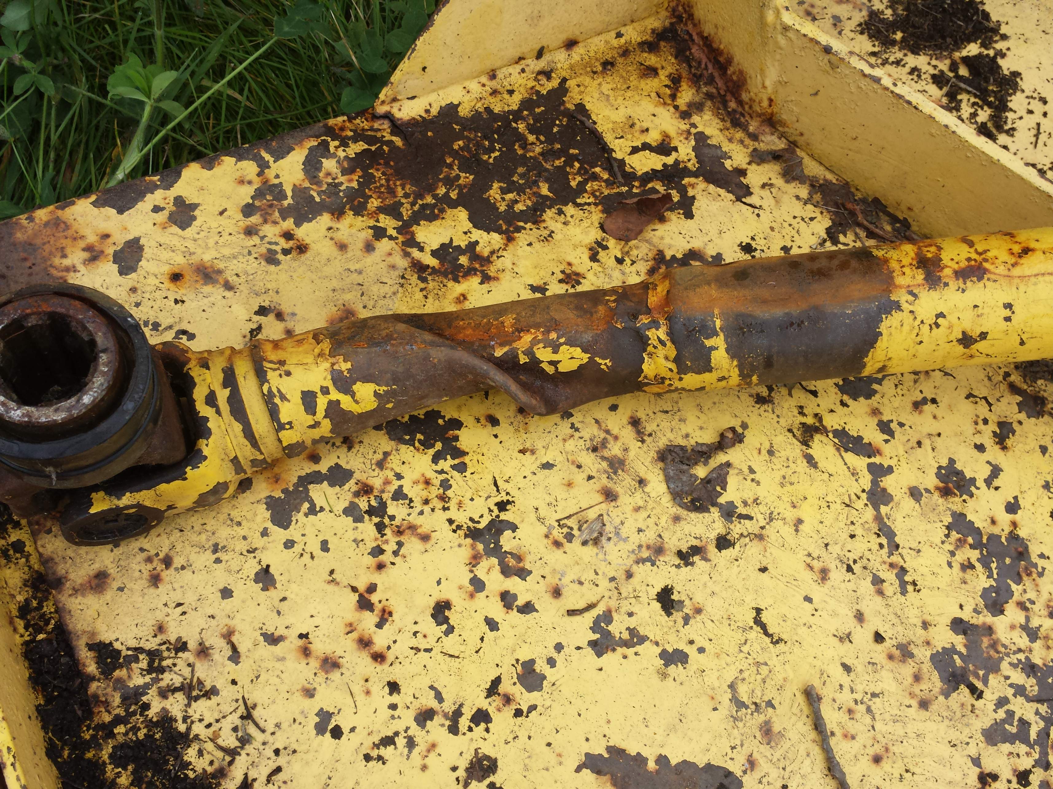

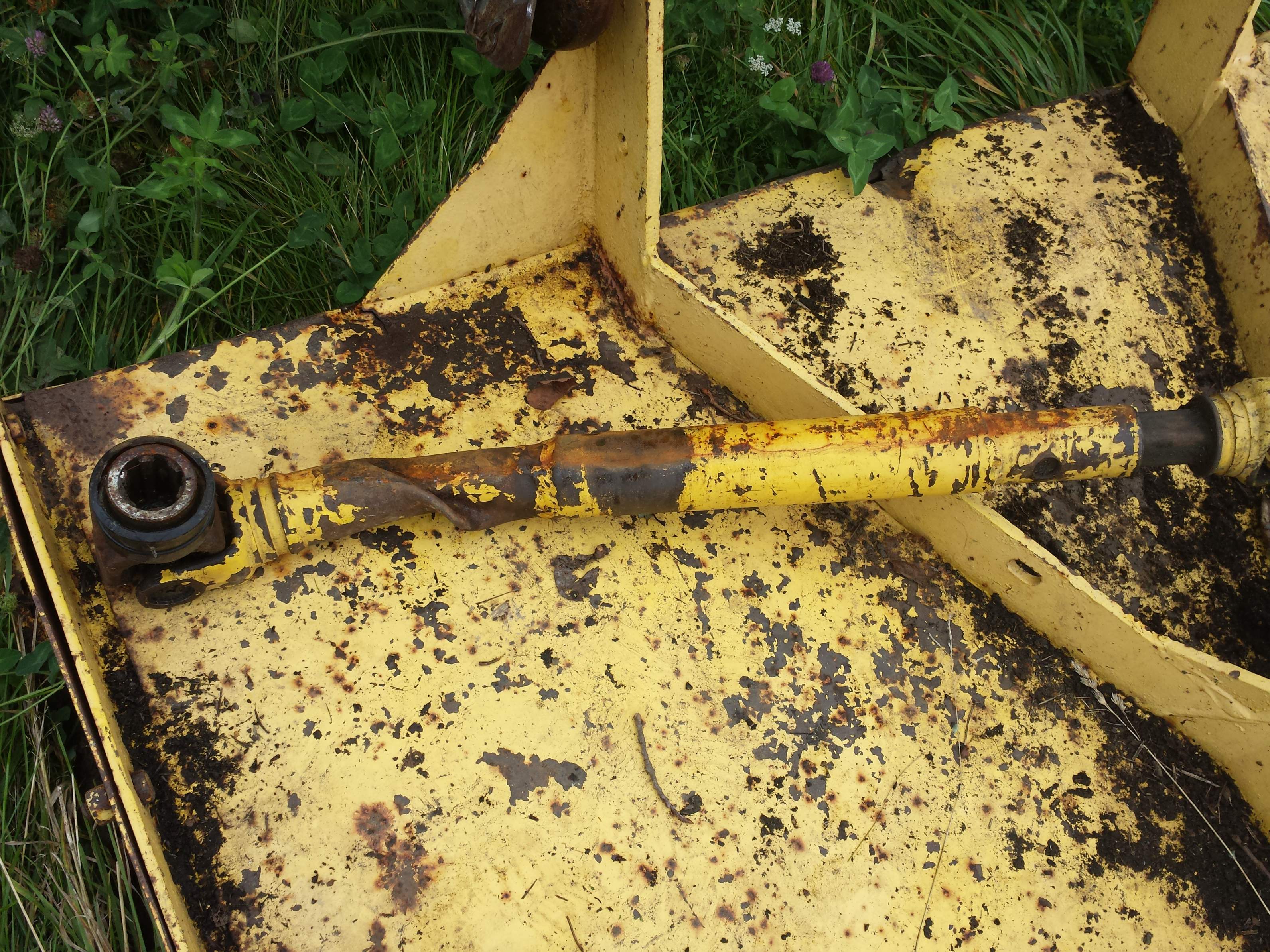

Hi folks,
We have a bit of a problem. Someone used a bolt that wasn't made to shear . The end result is that the whole shaft arm on our 5 foot rotary cutter twisted horribly .
What is the best way to fix this ? What should I do ?
Thank you so much !

The only thing you can do is replace the entire PTO shaft. Is your Duetz mule an air cooled unit?
   / I Have a Twisted PTO Shaft On a Woods Rotary Cutter what should I do now ? #3

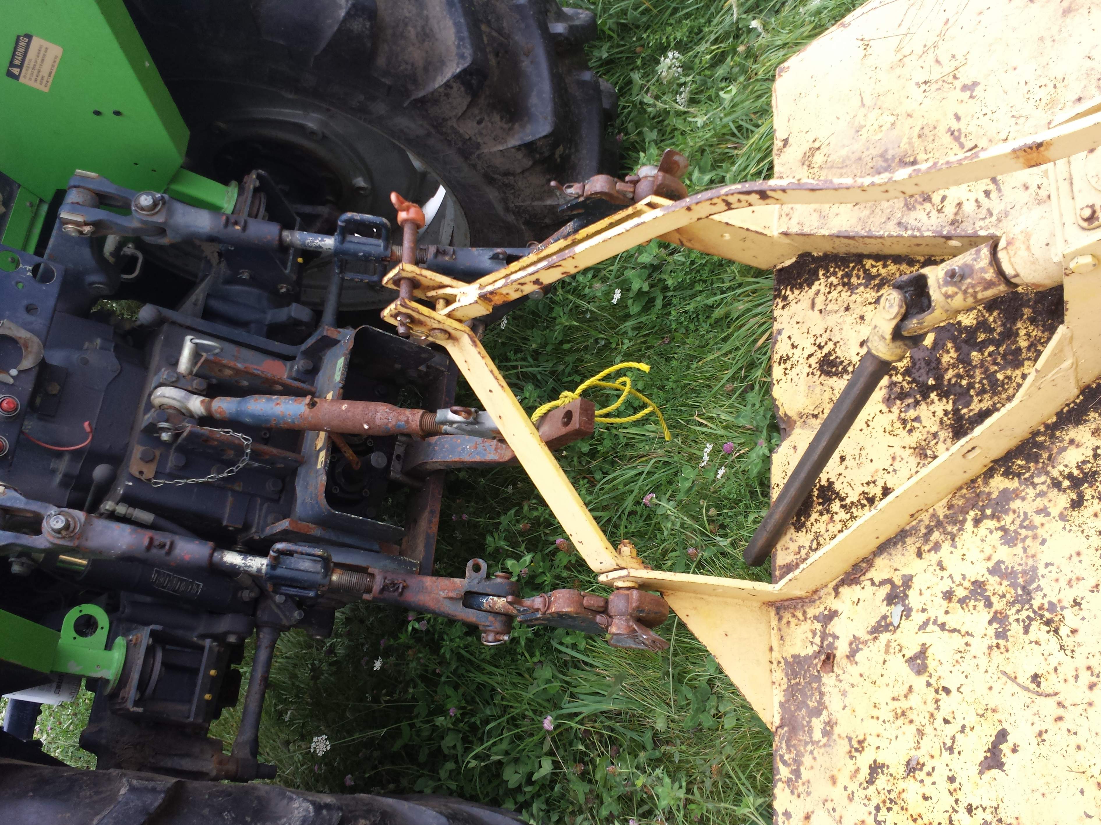

It looks like it made heavy contact with the top front of the mower deck at some point from lifting too high. Also, you have to watch contacting the drawbar when all the way down. The shear pin will not protect it from those types of impacts to the pto shaft.
   / I Have a Twisted PTO Shaft On a Woods Rotary Cutter what should I do now ? #4
Yep, time for a new shaft. This time get one with shields.
   / I Have a Twisted PTO Shaft On a Woods Rotary Cutter what should I do now ? #5
If you are at all handy you can just go to a farm supply store and buy the replacement part. There is no need to replace the entire shaft as all the pieces are available individually. It might be cheaper to buy a whole shaft than parts though. Do some measuring. Surplus Center has shafts for reasonable prices.

Surpluscenter.com and haytools.com have some of the best prices on PTO shafts. It will be cheaper to just replace the whole thing. Maybe $100-$150 will buy a complete one.
And make sure to get one long enough. Or even too long and cut it to size.

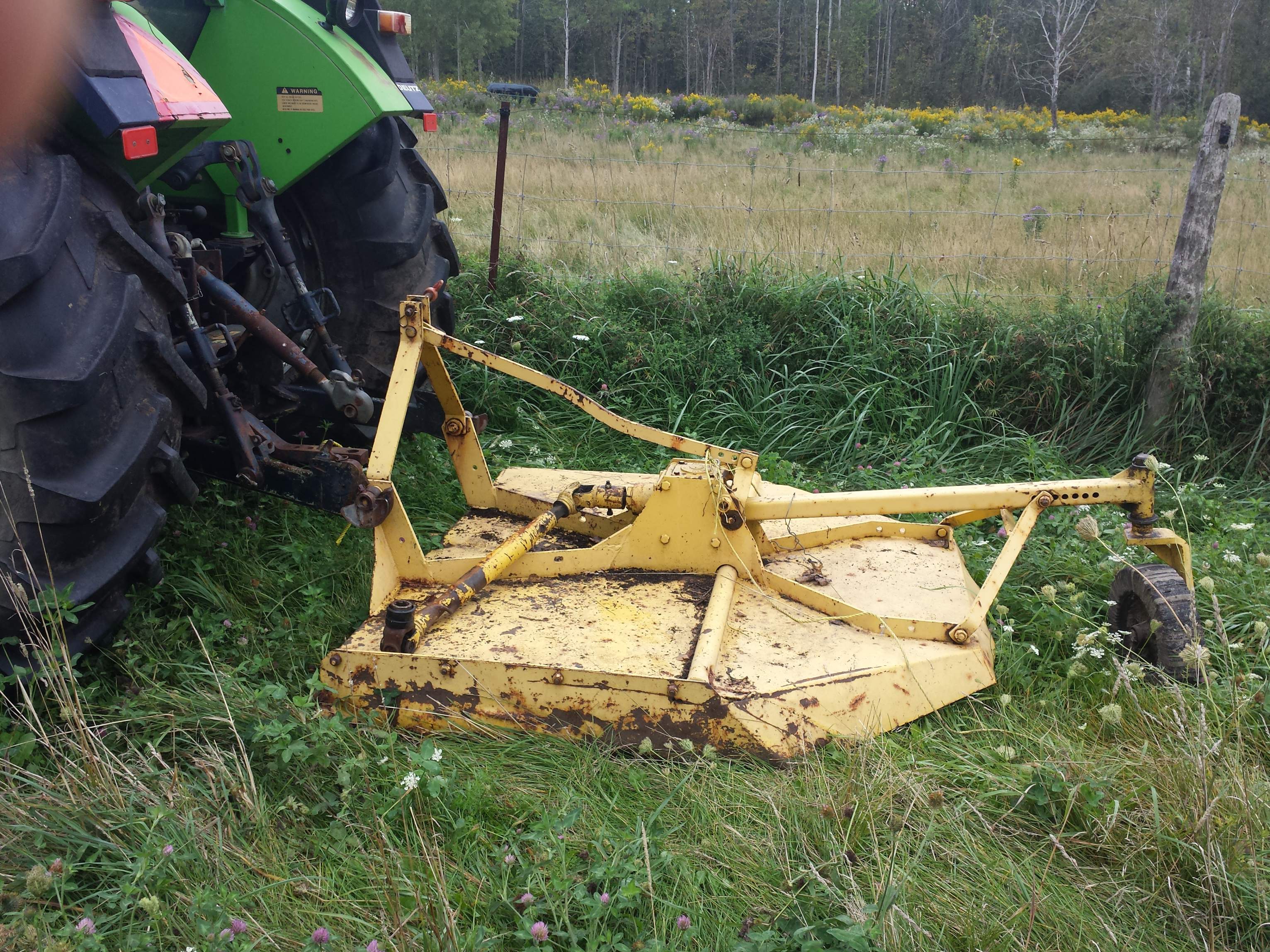

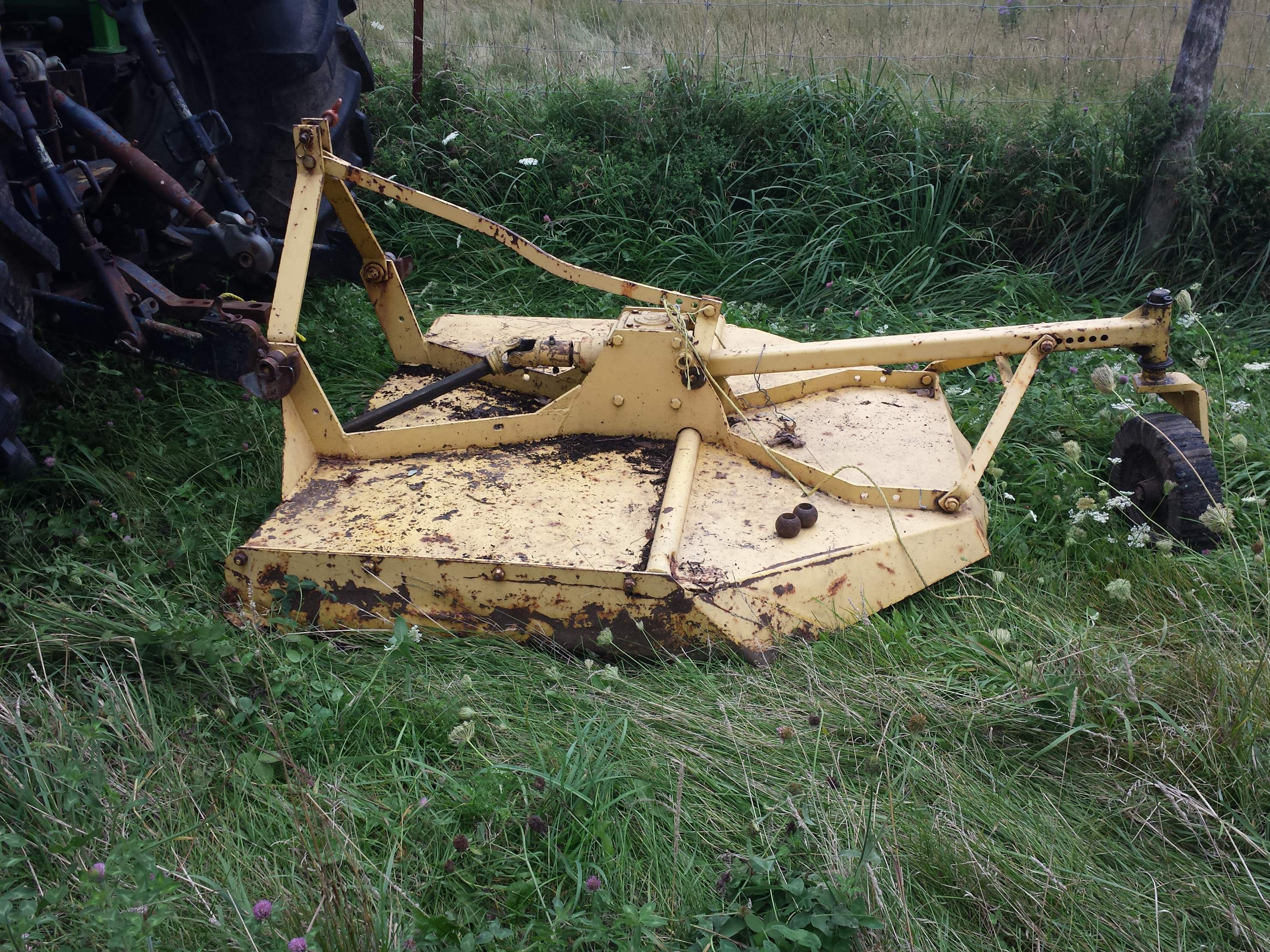

And I really think you need a bigger cutter. That looks like and old woods MD160. 600lbs maybe and likely a 60hp gearbox. Not enough machine for the 90HP you are feeding it. You need something with a little more substantial gearbox and driveline combo.
Was thinking the same thing!! That tractor looks big enough to handle a 6 to 8 ft mower pretty easily.

Thanks so much for the responses. The Deutz is air cooled . You are right the tractor is way too much for this five foot rotary cutter. The tractor itself measures 7 feet wide.
I will only be cutting a very small area . I will be very careful until I find the right size rotary cutter .
