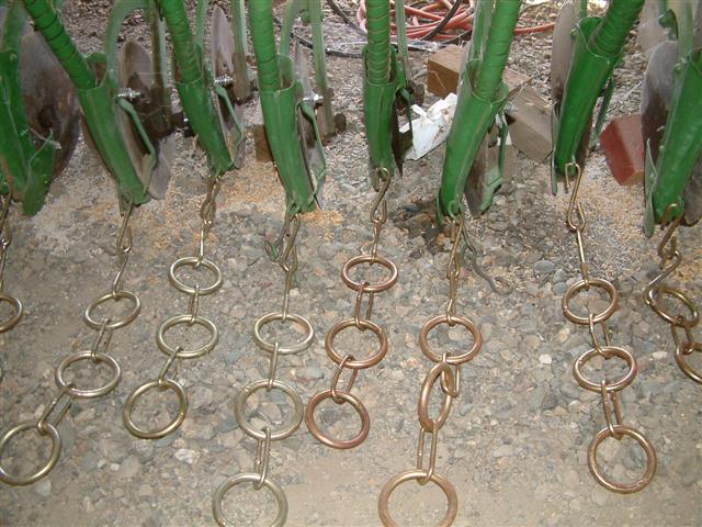

The seed is supposed to drop into the grooves made by the disc openers. I have drag chains attached to the boots at the end of the drop tubes to cover the seed.

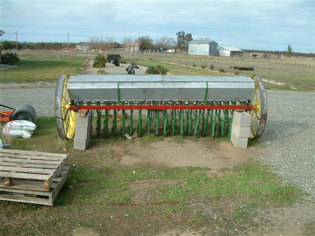

I'd add extensions to the seed tubes to get the ends closer to the ground. You can see from the photo above that the ends of the boots are only about an inch or two above ground level. This is important for small grass seeds like orchard grass that can be blown around by the wind if the end of the drop is too high.

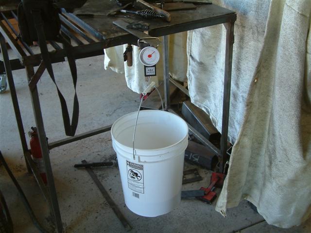

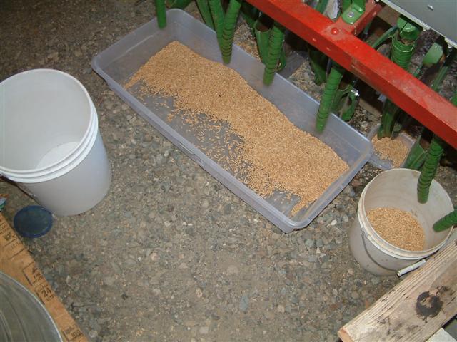

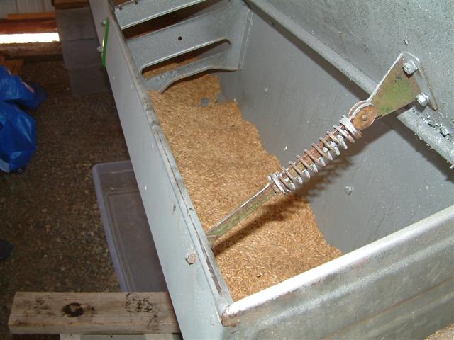

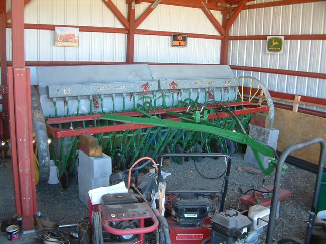

Here are a few photos of my Minneapolis Moline P3-6 grain drill that I restored last year (10 ft wide, 20 drops, single disc openers). I jacked it up and calibrated the fertilizer box for granulated fertilizer and oats.

You'll probably have to do something like this to calibrate your drill. Also, you need to clean the cobwebs from the drop tubes and check that your feed cups are working properly and are not clogged.
