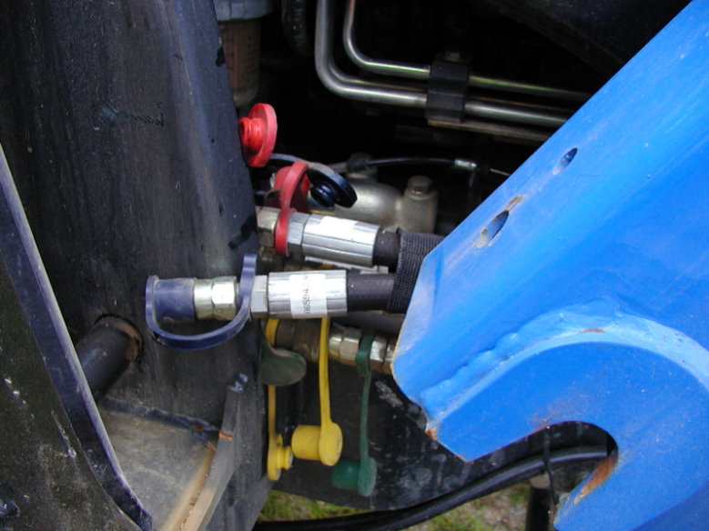

I decided to be very brave today and attempt for the Very First time. The removal of my 16LA loader. I have followed the manuals instruction to the letter and So Far, everything has gone flawlesly and exactly as described. But, when I went to remove the hydraulic quick couplers, I instantly noticed this little /forums/images/graemlins/confused.gif situation. My two sets of lines appear to be hooked up backwards, or atleast the colored safety caps are backwards. My lower Yellow and Green hoses / caps are crossed and my upper Red and Blue hoses / caps are crossed.
See attached photo.
I have owned the tractor for 17 months and never noticed this. To the best of my knowledge my loader works perfectly. My raise and lower and my curl and dump work as they are supposed to. So whats up with this little find ??? /forums/images/graemlins/confused.gif /forums/images/graemlins/confused.gif

Mark, on my tractor, the caps (tractor side) go red, blue, green, yellow from top to bottom. I think your tractor is the same way. I suspect your loader just had the colors reversed by mistake and they discovered it at your dealer but forgot to swap the caps on the loader side so they would be right. If your loader arms raise when you pull back on the joystick and the bucket dumps when you push the joystick to the right, I'd just swap out the dust covers while you have the loader off.
Also, in your picture, the loader post to the right has two holes. The bigger one (lower one) has a grease zerk fitting in there. While the loader is off is the only time you can grease that fitting.
Good luck with reinstalling your loader. Remember if it is in the sun, you may have a pressure lock and need to relieve the pressure on your quick-connects when you go to reconnect. Good luck! /forums/images/graemlins/smile.gif

Hi Jim,
Thank you for your quick reply. I was actually outside, having finished removing the loader and was giving the tractor a bath.
My colored coded caps on the tractor run exactly as you described. R/B/G/Y The loader side runs B/R/Y/G and Yes, my loader works as it is supposed to back is up and right is dump and right into the speed dump.
So I feel you are correct in that I just need to swap caps.

I did swap the colored caps, greas the zirks as Jim suggested and the loader reinstalled picture perfect. Now I feel much better knowing how it goes on and off and that I can do it. I feel much more intuned with my tractor now. /forums/images/graemlins/smile.gif /forums/images/graemlins/grin.gif
