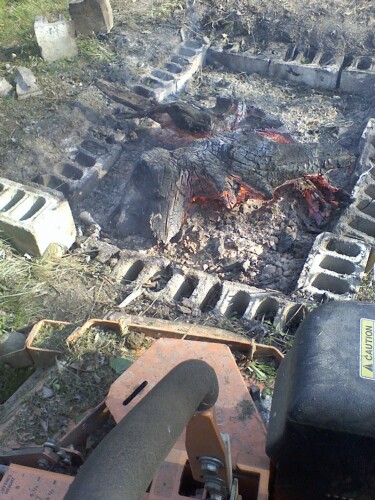

Almost forgot the second thing:confused2:
When burning down brush or stumps, and you get to the point where it is just smoldering and not really burning the last bits up.....
A strategically placed mower deck blowing air on the coals works wonders to re-ignite the blaze:thumbsup:
Its hard to see...but it is flaming pretty good
