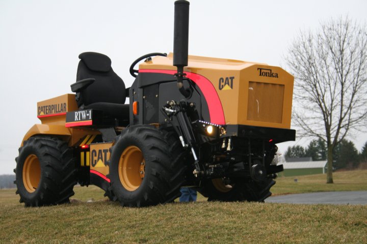

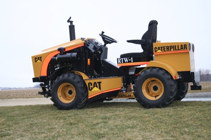

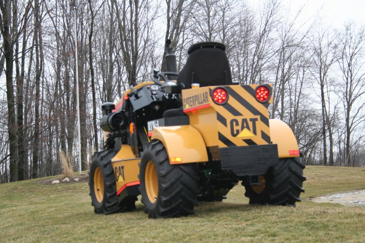

This is a project we decided to do after much brainstorming. My son and I love to do projects. This is 34 horse 3 cylinder diesel using an Eaton Hydrostatic 5000 psi pump and 4 wheel limited slip drive with High and low gears. Much thought went into the articulating part so that the tractor would hinge left and right as well as roll left and right simotaniously. We liked the idea of a Catapillar Tractor theme and went with that

Well actually we built the front end around attachments to our Steiner mower,snow blower and bucket loader. This thing turned out to be an engineering masterpiece. Thanks I'm delighted that you like it. THanks!
