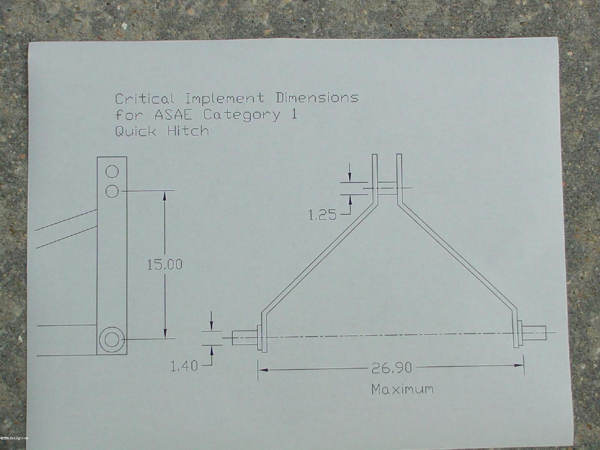

I have the I match for my 755. to make my implements i match compatable without going out and buying new. What do the hook ups on i match compatable equipment look like? maybe if some one had a few picks that would be extremly helpful

I'll try to paste this shortcut to a 9-14-2005 thread "I-Match Dimensions", "beenthere's" post of the standard. If it doesn't work, search for that thread. As I recall, there were several threads on I-Match and attachment dimensions around that time.
http://www.tractorbynet.com/forums/attachment.php?attachmentid=44664&d=1126671367
Hope this helps. It worked for me as I gave those dimensions to a welder to modify a splitter so I could pick it up with the I-Match. Let me know if you can't find what you need.
