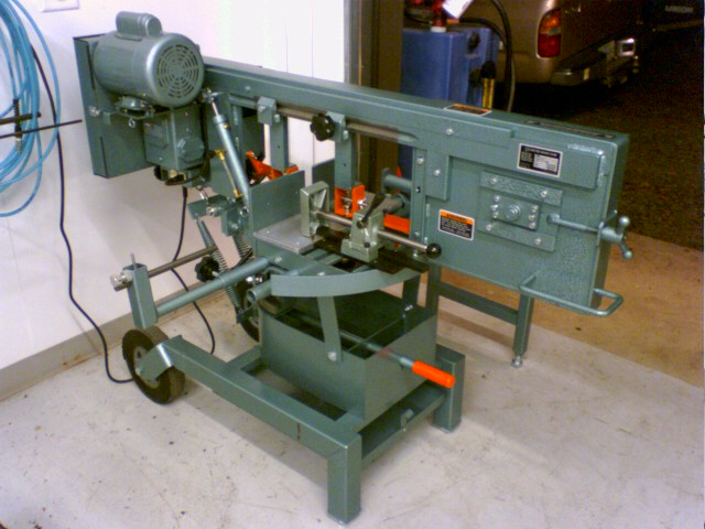

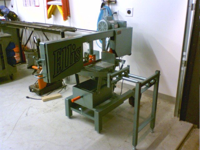

I have a couple of bandsaws, a small Jet and an Ellis 1600. The Ellis is simply awesome and there are no coolant issues to deal with. I also get great blade life with the Lenox blades I use.
/ I need bandsaw advice #11
One thing to watch for is a roller bed that you can set up next to your saw. Set them up level with the saw and you won't have to worry about holding up long stuff while it is cutting. Plus gives you somewhere to lay the drops while your cutting the next item in your list of things to cut. One going in and one going out work even better if you have the space for them.
I have some extra roller beds, purchased from a trailer repair shop, used.
None are cheap, but these are close...
David from jax
