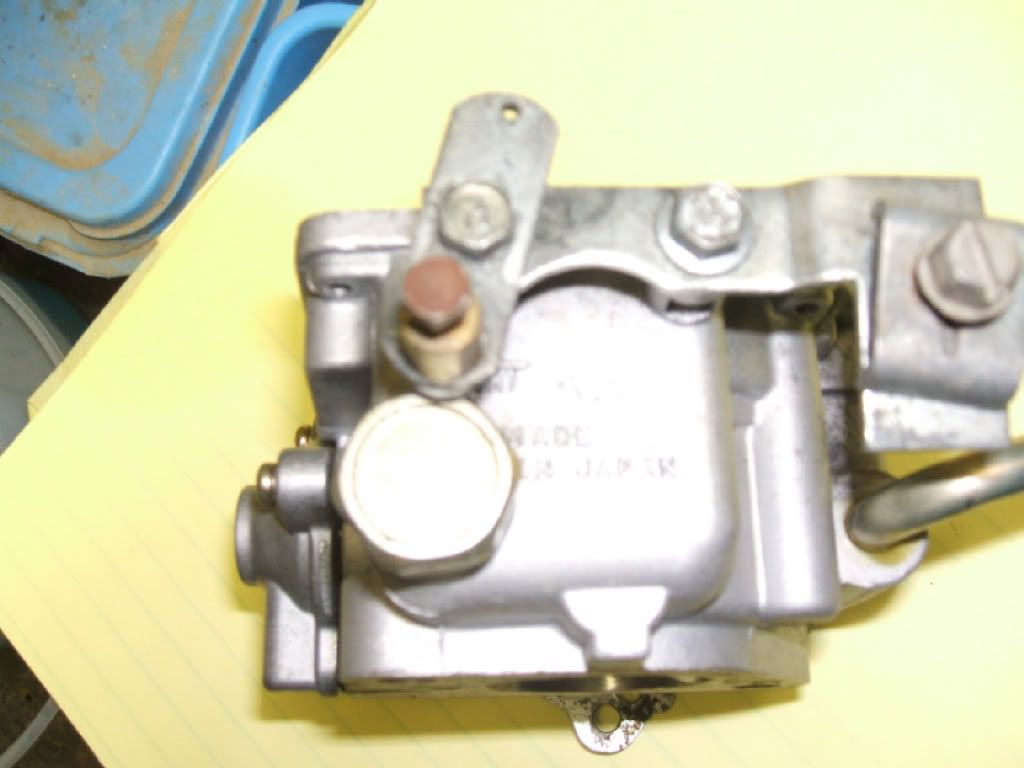

I had a chance, between rain and my schedule, to take a better look at my carb. I'm trying to understand what I'm getting into following your instructions.
Here are some pictures of my Nikki carb:
Left side:
Right side:
Right rear quarter view:
Lower right side (with brass cap):
Is the main jet hidden under the brass plug in the final picture? Thanks for your continued help!

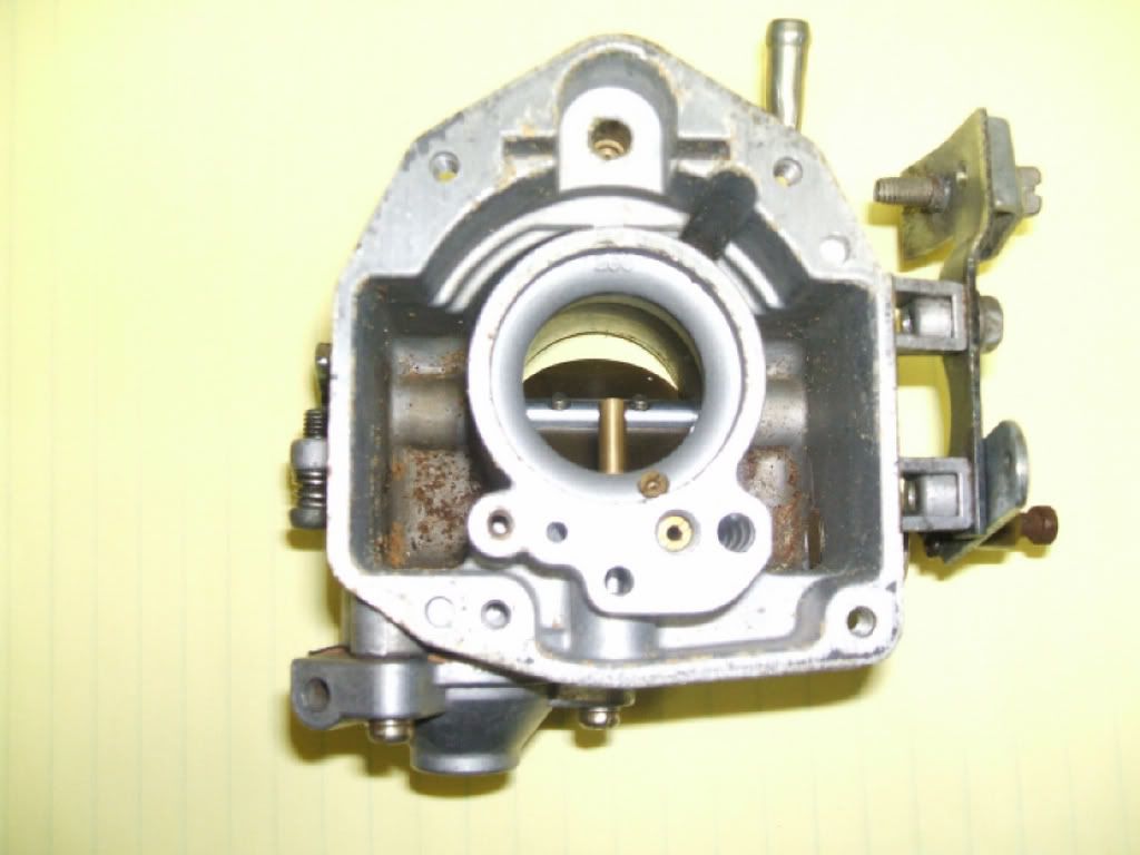

Okay the carb I have is a little older but the same basic design. There is a large plug on mine where your fuel shut off solonoid is that the main jet is behind.
Your best bet is to take the carb off and work on it in a flat pan. Take the shut off out and remove the top of the carb. Lift out the floats if it has them. Some of the newer carbs don't have floats. Then start spraying carb cleaner thru all the ports and jets. As you can see I havn't cleaned this carb since I took it off and there is a lot of junk in the bowl.
