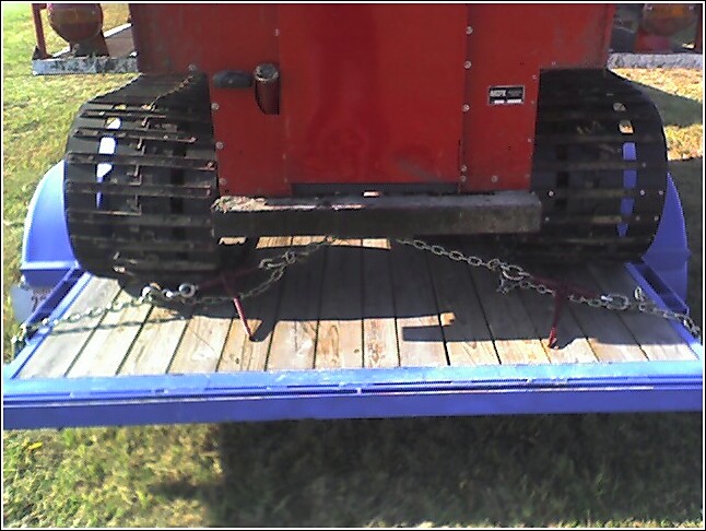

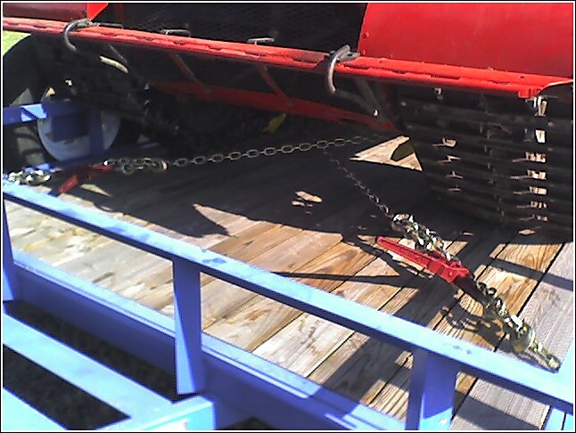

I use grade 70 transport chain, 4 for the tractor, one on each corner. As previously stated, there is also supposed to be a chain for the bucket and another chain for the backhoe. I use ratchet binders instead of lever binders, I prefer them. I've heard that lever binders are no longer approved, but they still make them and sell them so they must be. I just don't like the fact that lever binders can pop open.
AW Direct is one of the better sources for chain. I have the chain pictured below with the hook on one end and mult-hooks on the other end. It makes things very easy to tie down.
