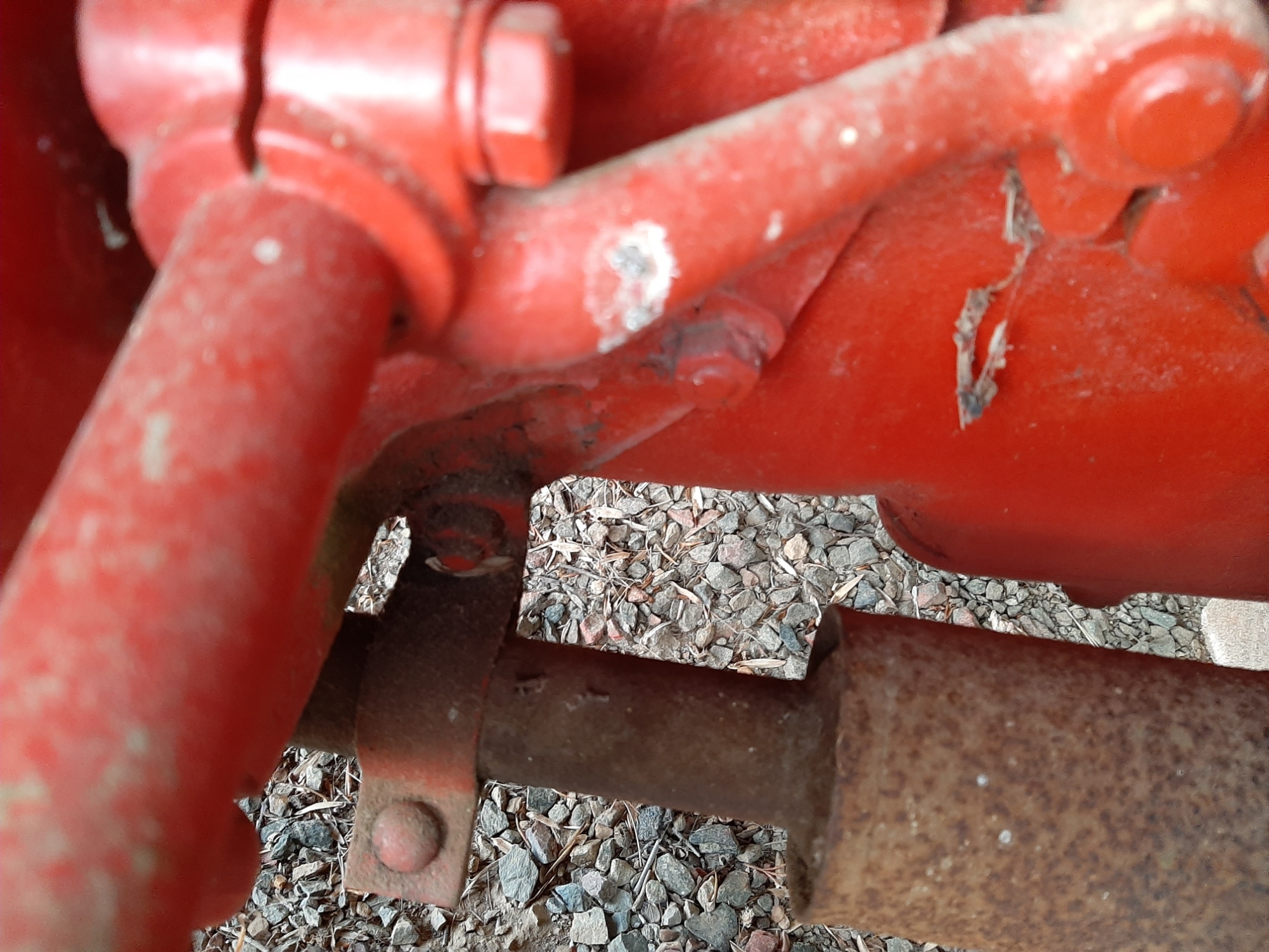

When I bought my tractor it had a janky upright exhaust and flapper that hangs open. I want to replace the exhaust with a factory style exhaust. I looked and TSC has the exhaust for a good price. I couldn't find the mount/hanger on TSC website that is located under the right foot board. Anyone have a picture of the OE mount/hanger or know where I can purchase one?

Yes, but I don't know how or where it mounts on or near the axle housing.
I'll go down in the morning and take a photo of mine. Stay tuned....
   / I need help with new 8n exhaust mount/hanger purchase. #5
It goes on one of the bolts/nuts that hold the axle trumpet to the center housing
