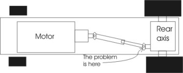

I have a gt14(ym14 in europe) form 1982 and i have some trouble to find part. I have big nose with the transmission from the engine to the back. I think is the end cardan used. Is anybody can help me.

Thank you very much for your help, It is the same machine as the picture of GT14. If you have some PDF of my problem to find the ref of the last cardan near the rear axle. Sry but my englis in the tecnical word is very small. I have a PTO system, but e begin old and make allso mose.

I think he means there is a noise behind the transmission and in the PTO assembly. A cardan is a U-joint.
   / I need some help on my gt14 #8
</font><font color="blue" class="small">( I think is the end cardan )</font>
Sounds like Yves is describing a noisy driveline, which he suspects to be a loose rear u-joint just ahead of the rear axle assembly.
Could the noise be the transmission input bearing? What else is in that location?

E drawing is better than a long discution.

More likely to be the U-joint than the pinion bearing on the diff, also far easier to fix. Just disconnect the driveshaft at the rear diff and see if the joint is stiff, especially when moved in one direction vs the other. Should be easy to diagnose and easy to fix too.........post up some pics if you can............
