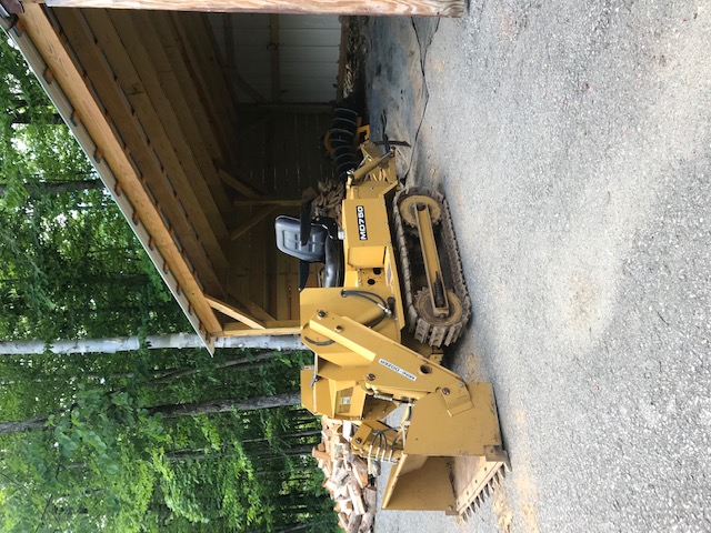

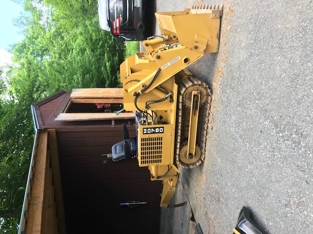

I have to spend this winter in ME to visit family in the nursing home.. So I bought this little guy to clean snow, the bucket is only 46 inches.
I'm trying to figure the best way To be able to move snow but I really don't want to alter the bucket to much because it's a good size for earth work..

I like the idea of the clamp on but I'm afraid it will slide around..

Take off the tooth bar and add these.
Edge Tamer Full Video - YouTube
If you need more, lashup a rear blade. Any ice and that thing will be moving sideways. Enjoy that entertainment!!
   / I Need Some Idea's On Adding A Snow Pusher For My Little Dozer #5
Put wings on that bucket! Done! Make them from stout material. 8th inch .
I plan on rubber pads and keeping a couple of inches of snow on the ground for traction..
