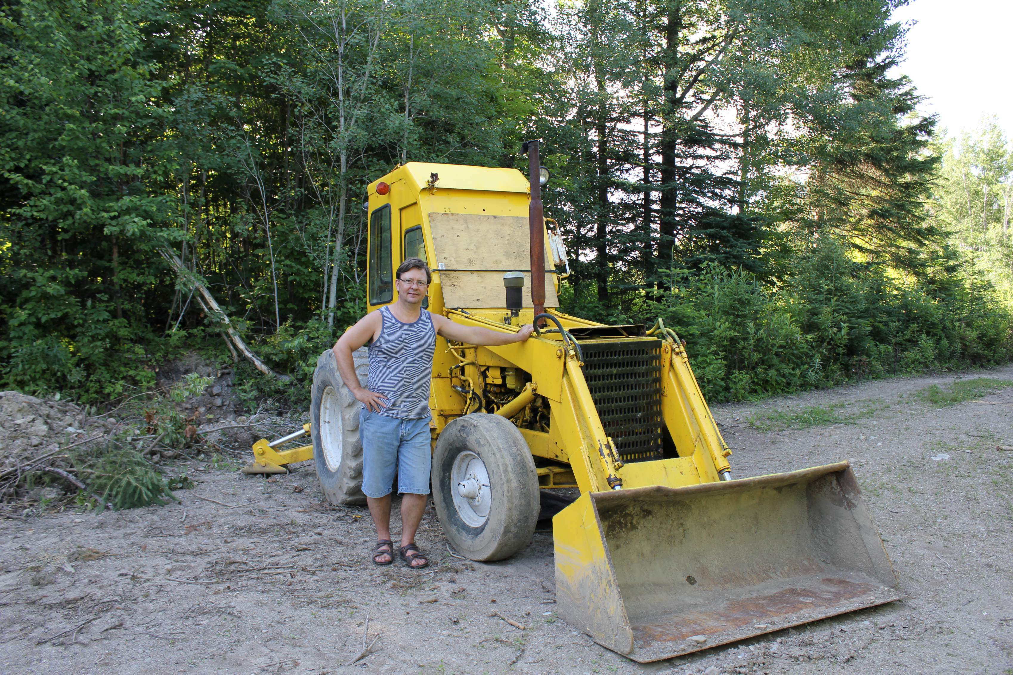

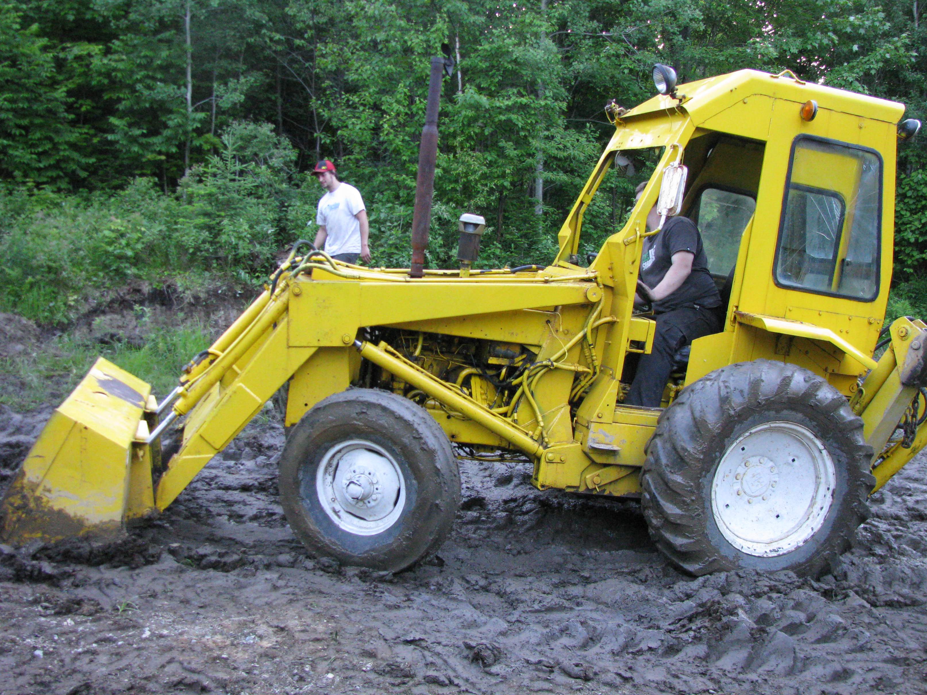

Hello everyone!
I originally posted this on the construction equipment board, but I was recommended to post here also, where the IH experts are. Hope someone can help me.
I bought an old International tractor last year. It runs well, but the brakes need repair, most gages don't work, and there's an oil leak from the steering column. Ok, OK,... it runs not so well! ...and yes I know that the rear tires are backward! I will swap them.
Before I buy the machine manuals to start repairs, I need to make sure what model it is. I couldn't find any indication about the tractor model, except that it is a IH tractor. Only on the backhoe can I see the "international 3130" mention. From various comments made by other people, I can guess that it's a IH 3414, but from pictures I could find, I didn't see an identical tractor. I also found a serial number on the engine block that reads 3040912R4
I post a couple pictures to this post in hopes someone can confirm that I indeed have an IH 3414 tractor. If someone could give me the year of the tractor that would be fantastic!
Thanks in advance
PierreR
   / I need to positively identify my tractor! #2
The serial no you quote is not a serial no !!!
It is the part no of the crankcase casting of a BD 154 engine which would be fitted in a 3414 loader/backhoe as pictured.
   / I need to positively identify my tractor! #3
I think you have it as it is a BD 154 engine from the looks of it.
   / I need to positively identify my tractor! #4
Looks nearly identical to my IH 3414, minus the cab. They were built in Great Britain as part of International's industrial line. Engines available were a BD154 diesel and a BC144 gas, which mine has. I was told they were built from about 1959 to 1965. Mine is a 1963. Tough old machine. I heard the engines were made by Perkins, which last forever with a little loving care......Dan.

Thank you gentlemen !
I think I can confidently take it that I have a 3414 ! I just ordered the service manual for the 3130 backhoe and the service manual for the 3414 tractor from Jensales.
