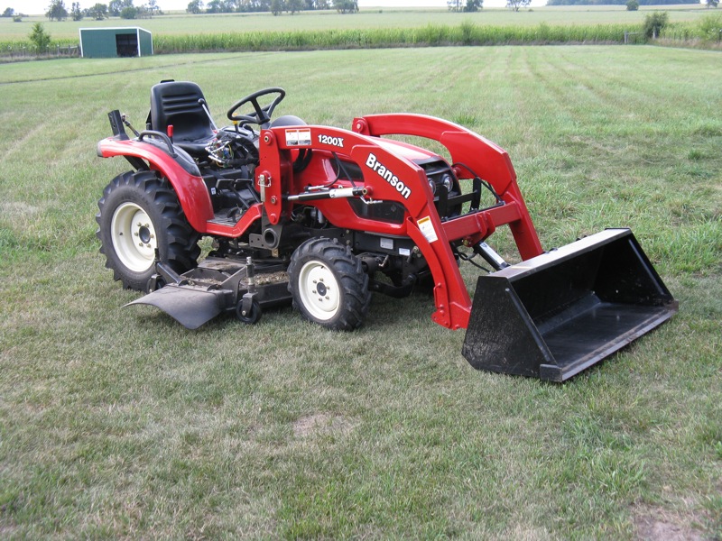

Well last night dealer called and said they had replaced the steering control valve on the 2400H so I took it out for a test drive around the lot and then brought it home with me. Since we have company coming today I had to get the lawn mowed so pictures will have to be posted later today.
2400H with R1 tires, 60" MMM & 1200X FEL

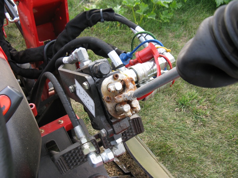

1200X FEL: Haven't used this enough but there seems to be some roughness or binding of the joystick when trying raise and dump simultaneously. Suspect slight linkage bind and will have to investigate this when I get time.

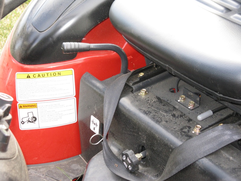

Differential lock lever: This is hand operated on the HST models and due to the way I sit this levers rubs the back of my calf especially when using the bush hog. Hopefully a simple modification of the lever will eliminate this also. Pictures to follow.

Overall happy with the tractor
